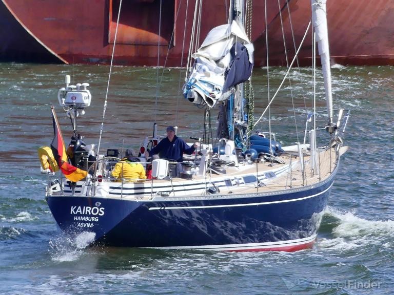

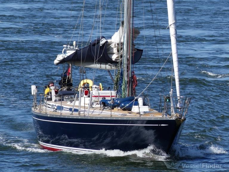

Hi Matteo,
finally a couple of pictures - not under sail but at least 'in action'!
Refit was completed in time early April 2022 and after a couple of months in the Baltic Kairos particpated in 'Nordseewoche' regatta on Heligoland before departing for the West coast of Norway.
Current position is Trondheim with the next crew aiming to go further North to Bodoe.

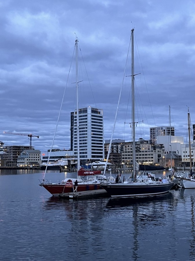

Kairos met Berge Viking in Bodoe, Norway earlier last week.
Two beauties spending some time together :-)
Kairos - 57/043
Berge Viking and Kairos in Bodoe, Norway

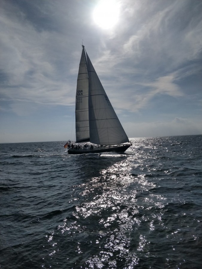

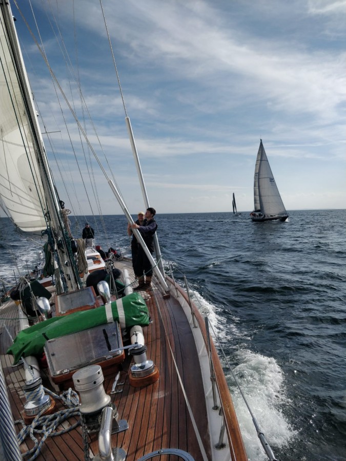

Dear all
Finally some photographs of Kairos 'under sail' from our last trip of the season earlier in October; Kairos participated with a crew of students in a regatta for 'young crew' from Kiel to Travemuende, approximately 95 nautical miles.
Photos curtesy of 'Gemania VI', also an S&S design but not a Swan.
Kairos is now back in Winter storage and we are looking forward to the next season.
Fair winds everyone.
Stefan - SY Kairos 57/043
PS: Yves - good to see that you managed to squeeze some sailing in after all in the end!
Kairos
Germania IV gaining on Kairos ... 21m vs 17.5m :-)
