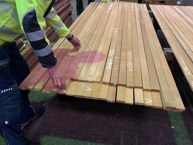

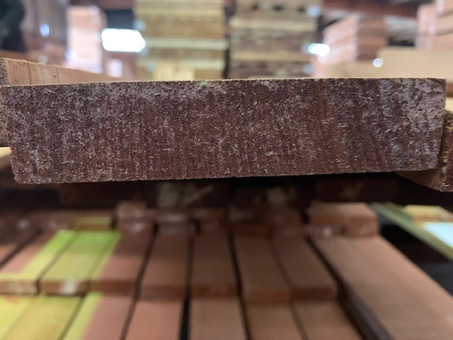

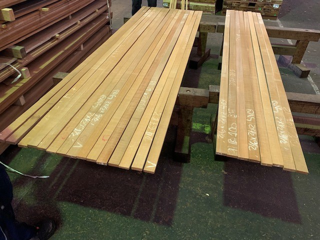

Hi All,
first step towards our new teak deck has been taken - our yard went to select the teak from their wholesale supplier.
They spent some time to select each plank individually and reportedly rejected 40% of it due to quality/inadequate standing annual growth rings.
The planks are slighly wider and will be plained to exact size at the yard.
Some pictures below,
fair winds

Dear Stefan,
wow that's a very good way to do the teak deck job! Looking forward to hearing from you more on your project!

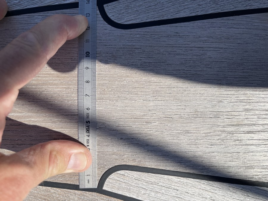

What is the width of your teak planks?  And also the width of the borders?
Thank you.
Chris  Mabel's Casse Tete 43/003
26 May 2021 - 16:36
#27
Dear Chris,
38 mm. Will tell you about the borders on Sat!
26 May 2021 - 16:44
#28
Thank you!
30 May 2021 - 08:05
#29

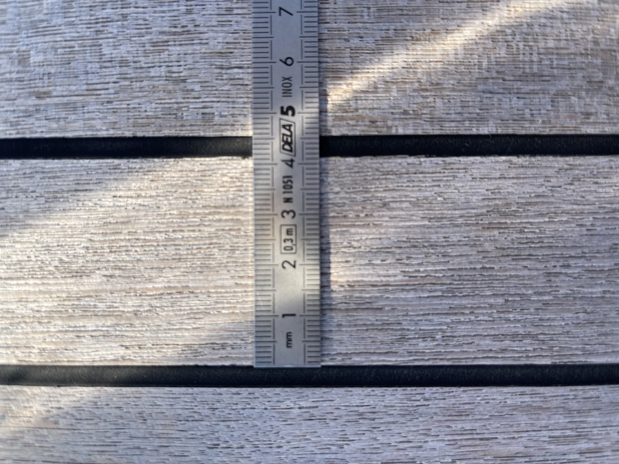

Dear Chris,
Amendment:
Plank width 40 mm.
Master Plank width 70 mm.
30 May 2021 - 19:54
#30
Thank you so much for the helpful information.  Pictures are perfect!
02 June 2021 - 09:10
#31
Hi Chris,
the width of Kairos' new teak planks will be 42 mm, which I understand is the same width as the current plank width.
Kairos - 57/043

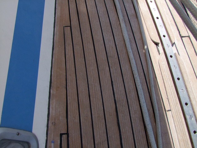

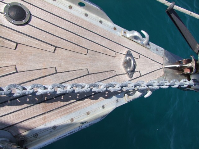

as seen in your picture, the original plank broadth might be 45 mm  because of the step under the joint, and the measure upside 40 mm as shown. My deck has the same measures. If I remember well, the broadth of the original deck was slightly larger, 50mm and 45 up

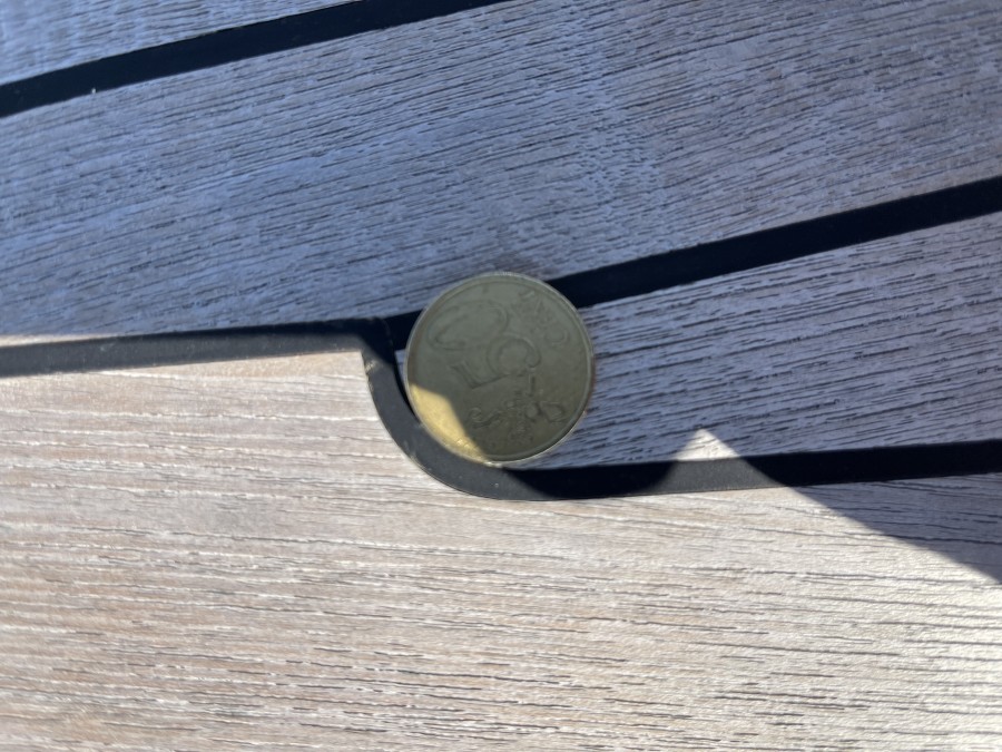

Rumtrader had her teack deck replaced in Turkey in 2009.
I estimated that she had the orginal teack deck so I took pictures of old deck and measured some specific details.  My objective was to have the new as close as possible to the original design.  For example the plank on the side were narrowed to give a longer and thiner visual effect (see picture below).
I also had to explain very clairly that I wanted no round ending but the cut ending as you can see on the picture before.
The teck was glued, no screws and all old hole were filed with epoxy.  12 years later the teack is still in perfect condition.  I have not done anything (not even cleaning !).
This work has filled all my dreams and participate to my pleasure every day I am on board.
 Ludovic of Rumtrader
New teak deck
old teak deck
old teak deck side
02 February 2022 - 09:16
#35
Dear Ludovic,
it looks they had a very good "rigatino" quality of teak, nowadays very difficult to have. Do you know which caulking brand have been used?
