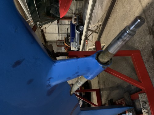

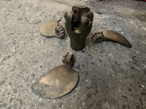

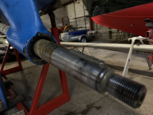

Finally removed my old prop. Think everything is fine to place the new one. It will be the flex-o-fold, three blade.

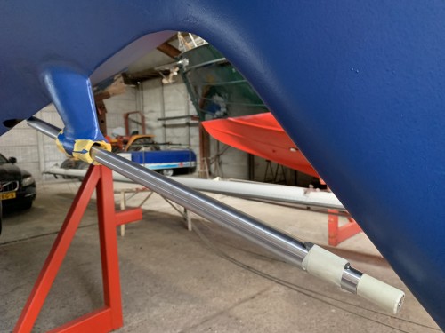

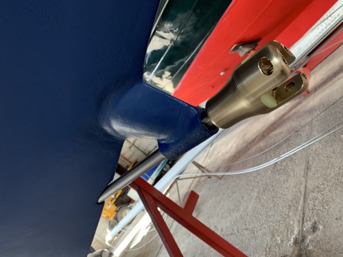

Installed the new prop and new propshaft and cutlass bearing! Installed the shaft without removing the engine!
