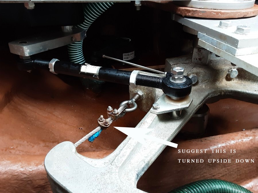

Dear Stefan,
a very clean installation indeed.
Can I suggest you turn of 180 the second clamp (see attached photo)?

Matheo: thanks for your effort and reply, yes of course thats better to turn it 180° arround. On hose clamps i allways do, if two are installed. Did that ones in the beginning of my refit and never touched again.

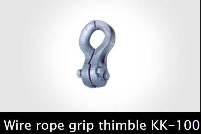

Dear Matteo and Stefan
The original steering cable attachment at the quadrant did not use wire clamps but a special combined thimble and rope grip with better load capacity.
https://www.gunneboindustries.com/Lifting/Products/Steel-wire-ropes/Steel-wire-rope-components/Wire-rope-grip-thimble-KK-100/
10 November 2020 - 10:19
#26
thanks! This is exactly what I have on Vanessa cables, did not know they were still available.
What a good news, thanks dear Lars!

Hello professor,
I apreciate your effort for finding this special clamp.
Back in germany i will get two of them from Certex in düsseldorf.

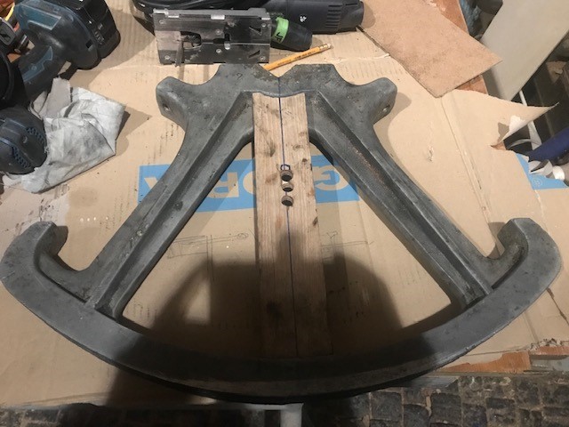

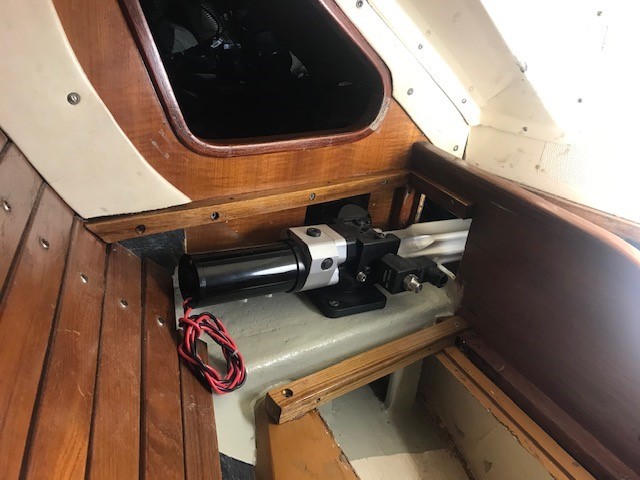

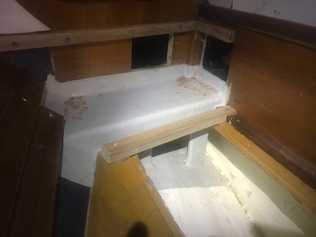

Finally (sorry it took a while) I have some pictures from Swan 40 (1972) with a high molded fuel tank. The autopilot work unit is B&G T2. In the pictures you can see the structure for the linear motor (before decorative housing) and the welding proto for the rudder. Unfortunately I don't know how that part is called. Nice work done by Veneveistämö Pettersson / Suomenlinna, Finland.
27 January 2021 - 20:12
#33
Join Date: 31 October 2020
Posts: 11
^typo....it is a hydraulic work unit, not a linear motor. :)
