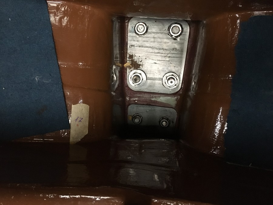

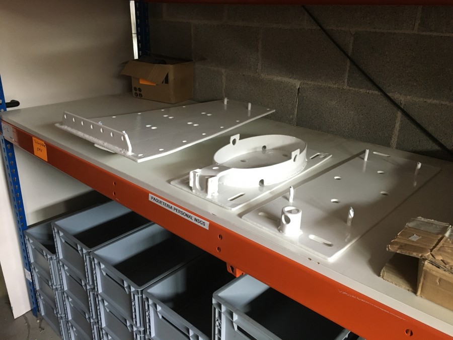

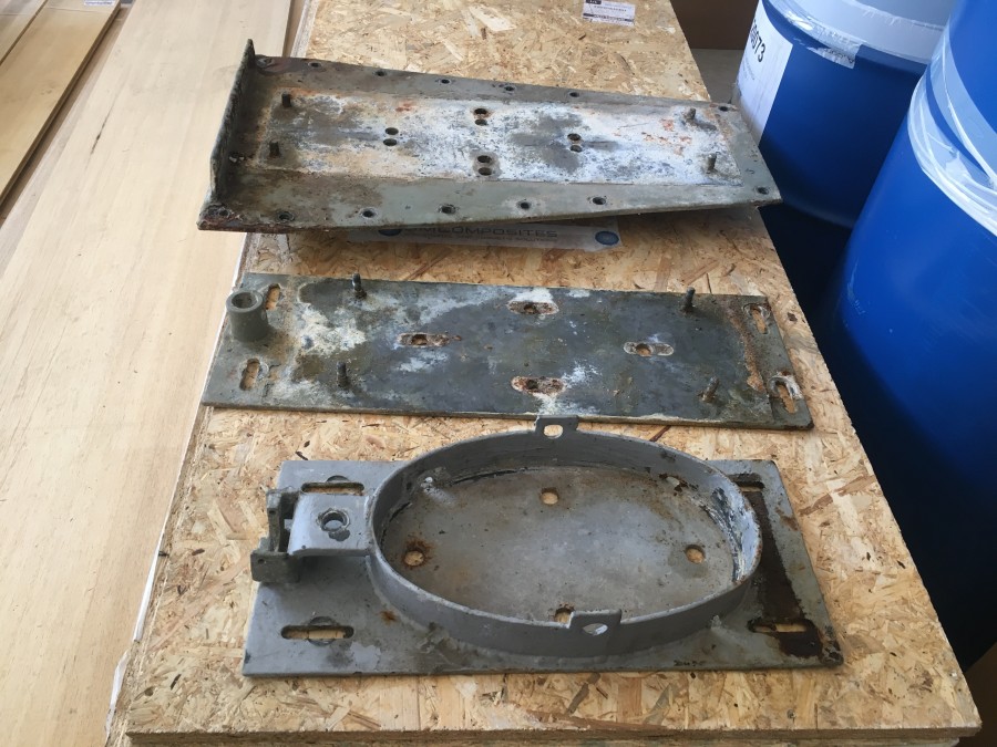

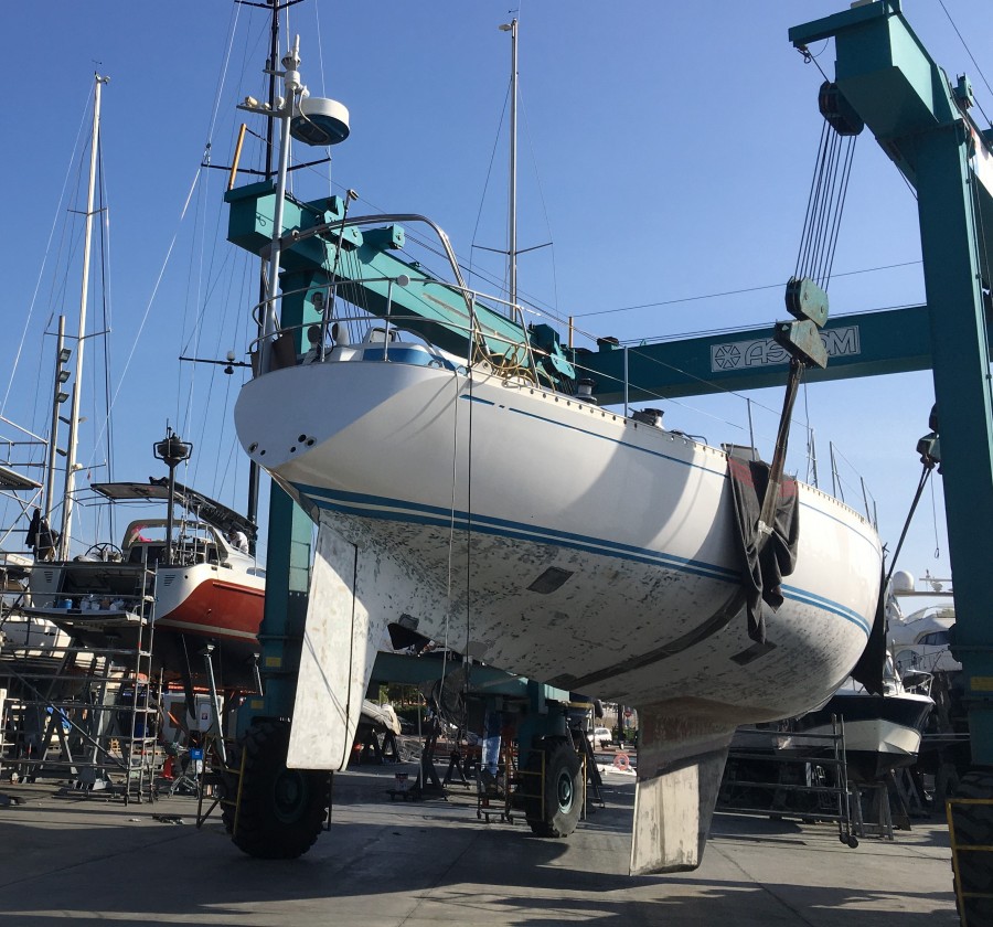

Hi Adrian, I have no idea of the brand of this paint, it is still used by Nautor on old Swans… I will ask Paco in Badalone yard if he knows. Now some updates about Algol on following pictures : Algol and keel close to join… Joined !!! The new plates and bolts |

Sorry for twice update Matteo, can you delete the doyble ? I continue my updates : Mast step when removed Mast step sanded and electro painted ready to go back in place One tank coming back onboard after repair with new sensors |

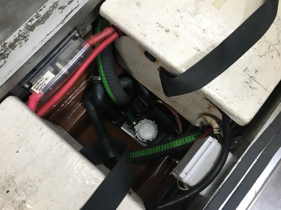

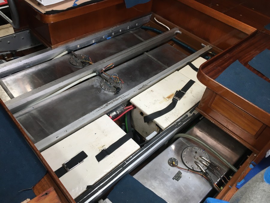

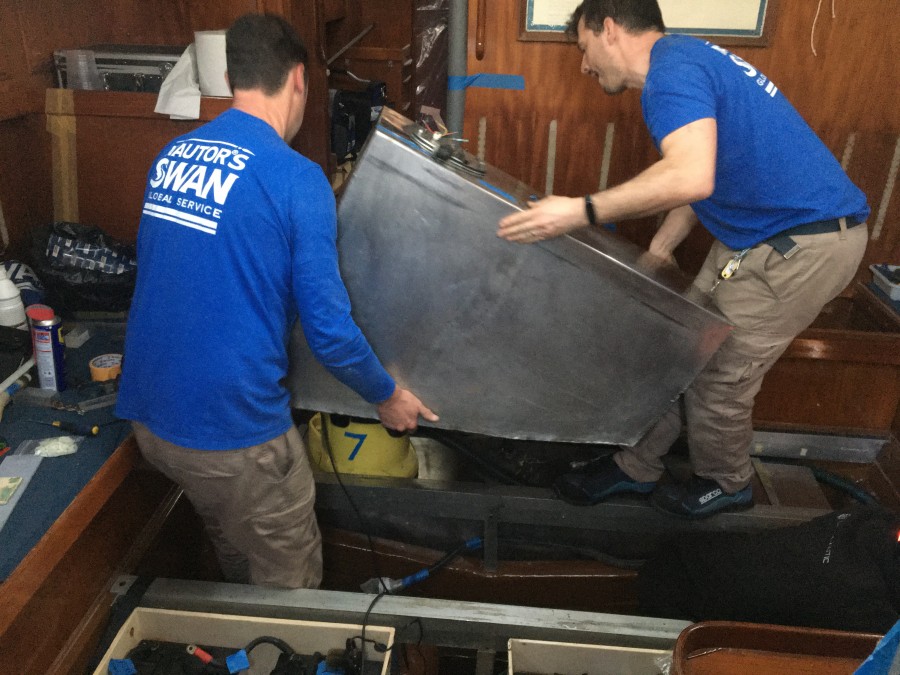

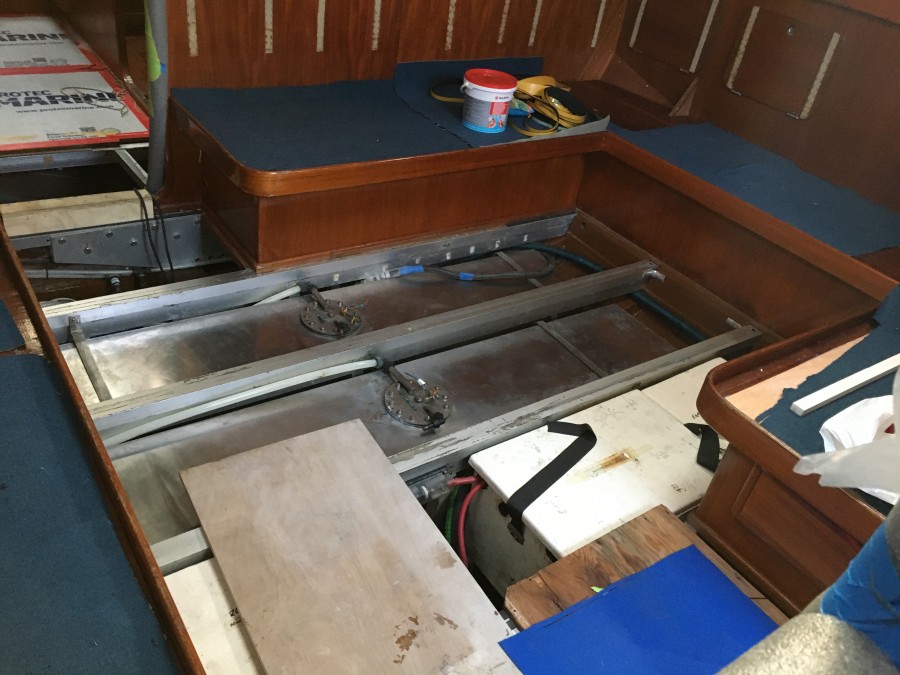

Internal rebuild, last update for today… water and fuel tanks back in place, with some repairs and new gauge sensors, batteries in place too, rewiring electricity and plumbing refited… One of the water tanks All tanks and batteries in place again |

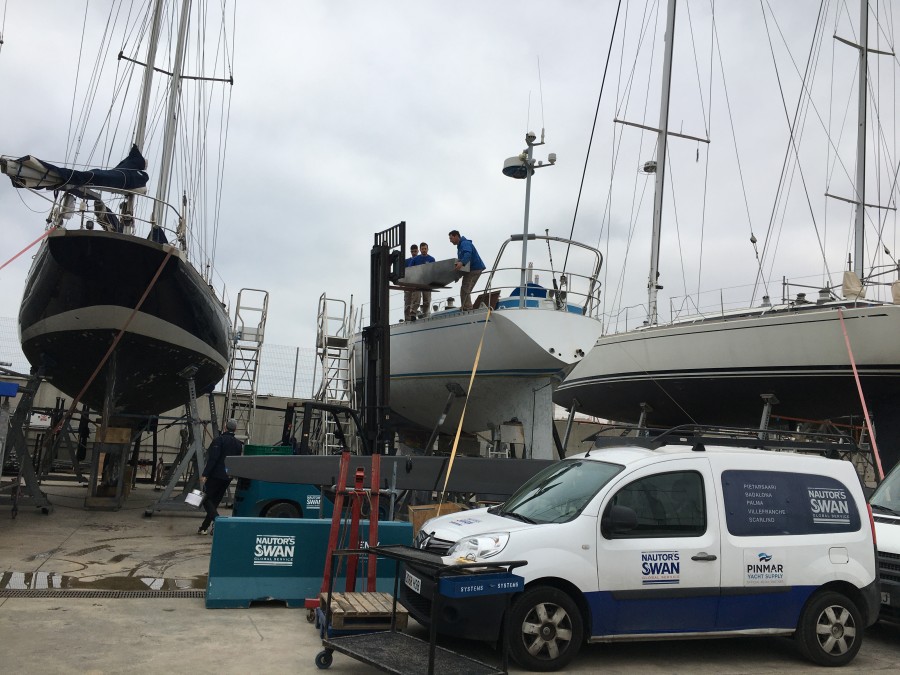

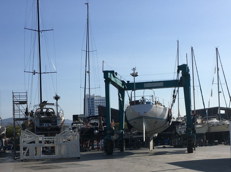

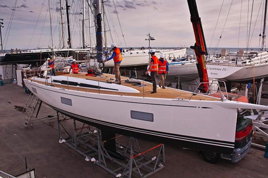

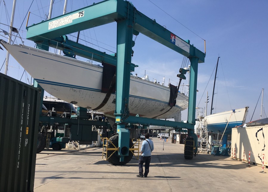

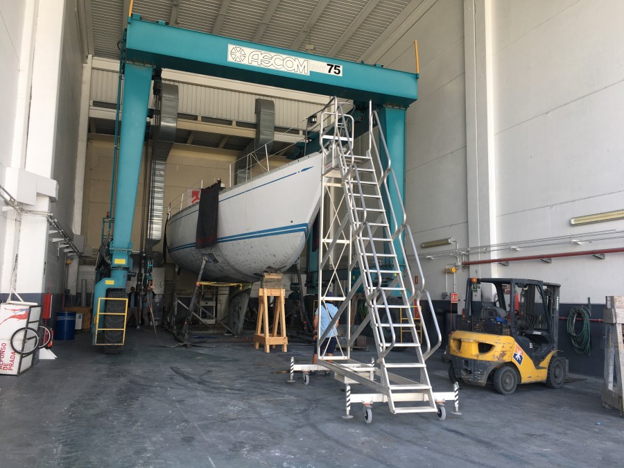

Glad to show how perfect are in line keel and rudder after works ! and some images from the yard stolen on the net… a little old S&S Swan 57 between much bigger modern ones… Happy ! Badalona yard on instagram The brand new Swan 58… and 57 in the back… |

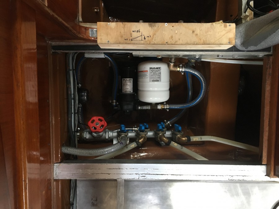

Beautifull clean bilge now !!! Renewed tanks New bilge pump New water manifold and pressure system |

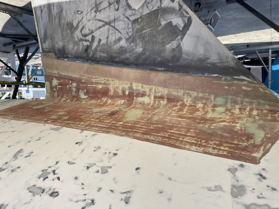

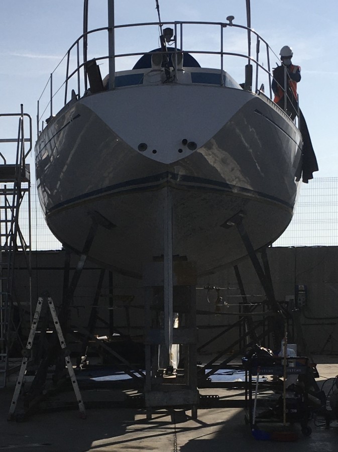

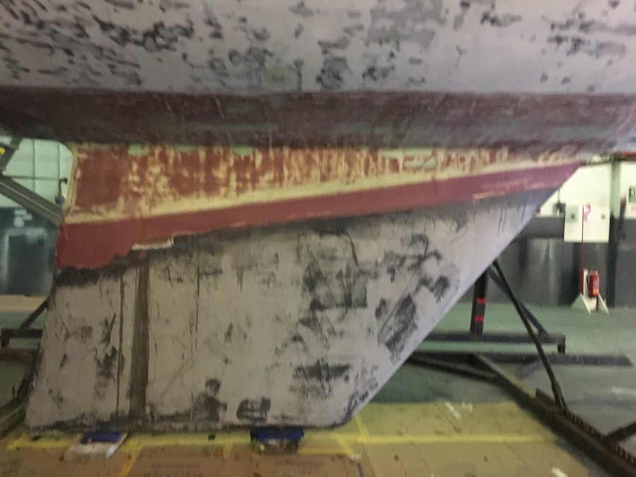

hello friends ! some news from Algol, taking a little promenade to go in the shield for some paint jobs... yves (Algol V - 57.007) Promenade in the shield new false keel, sorry bad quality... |

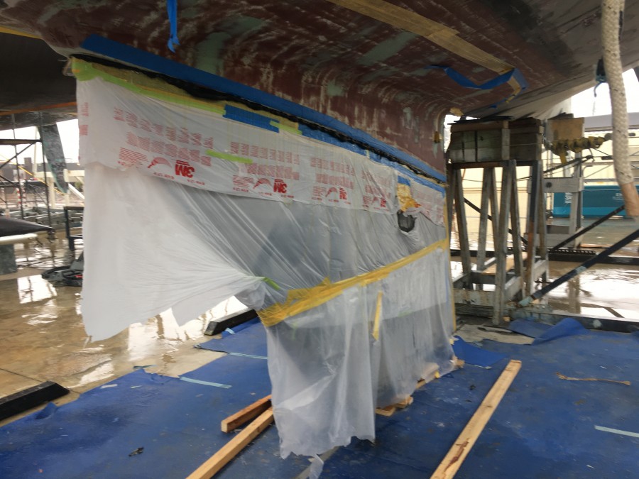

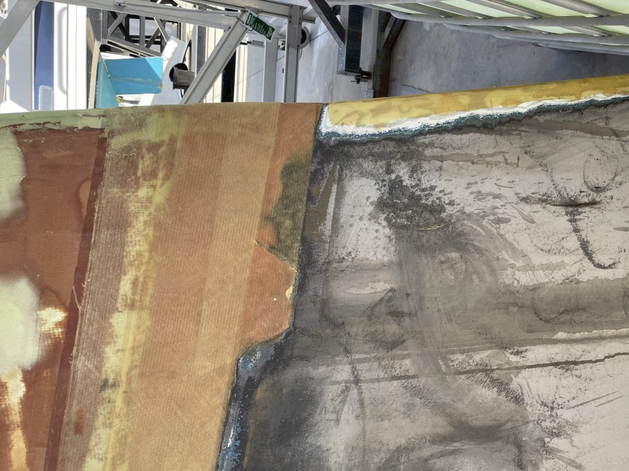

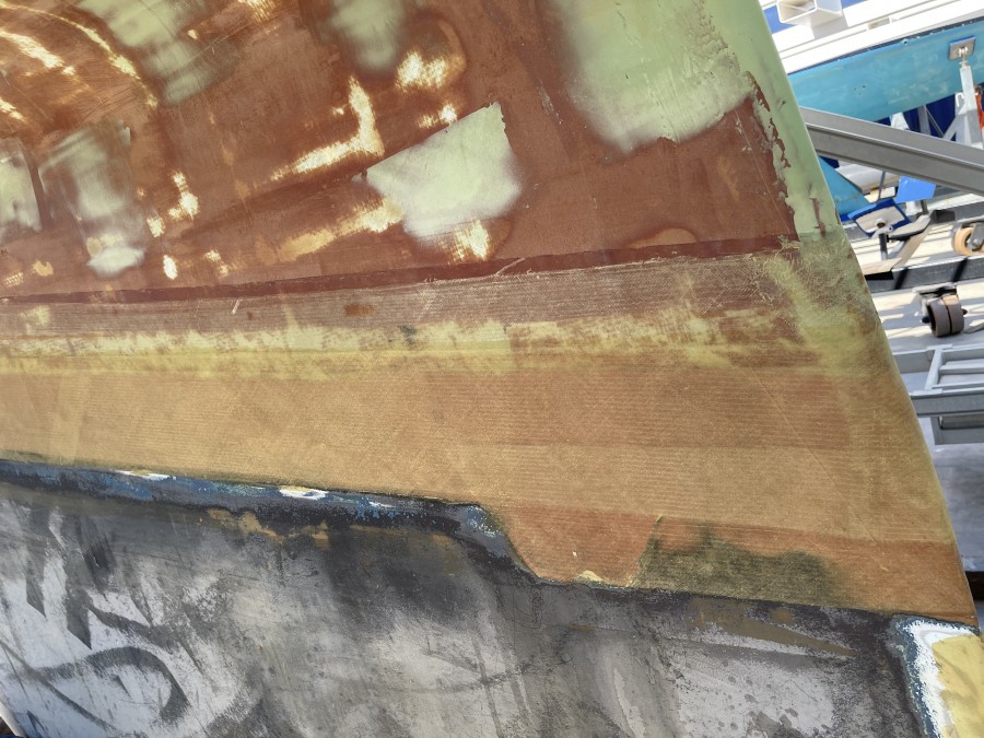

hi, just a final zoom on the rebuilded area, completely finished. as other jobs are pending onboard, the yard wants to wait before painting, and will do this job at the end... finished, waiting for paint, the later the better... |

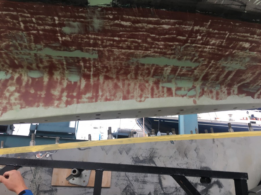

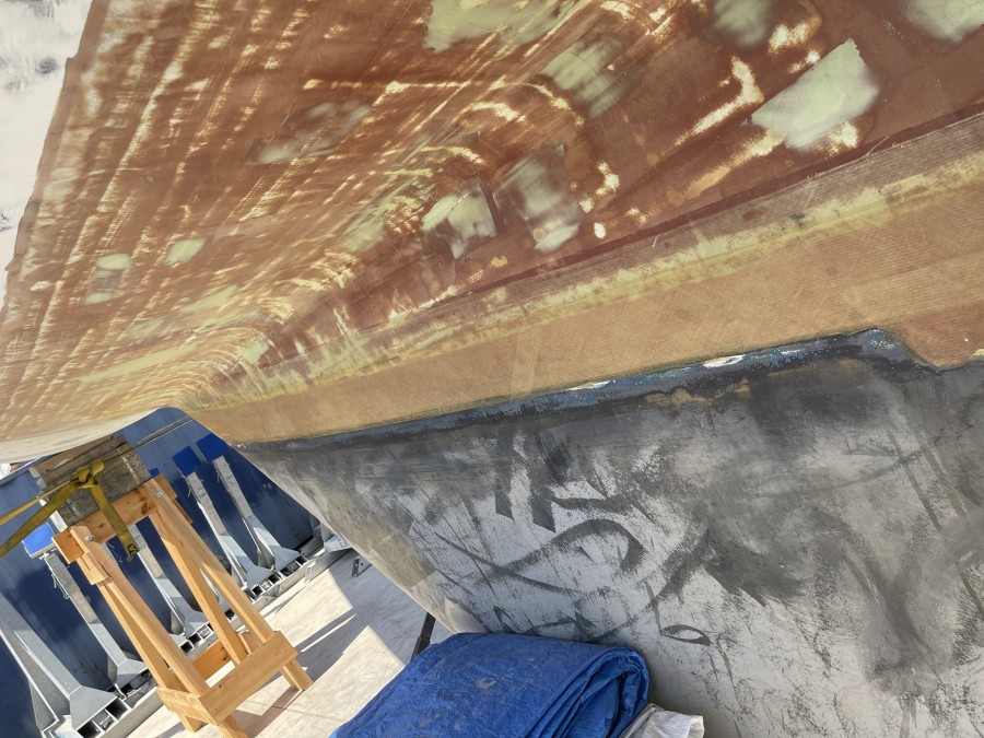

Last reinforcement of keel/false keel junction, 2 months after reinstallation of keel, as the boat is still on hard, to perfect finish before hidding all under paint... |
