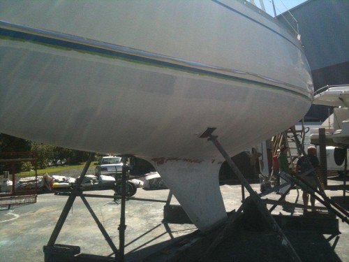

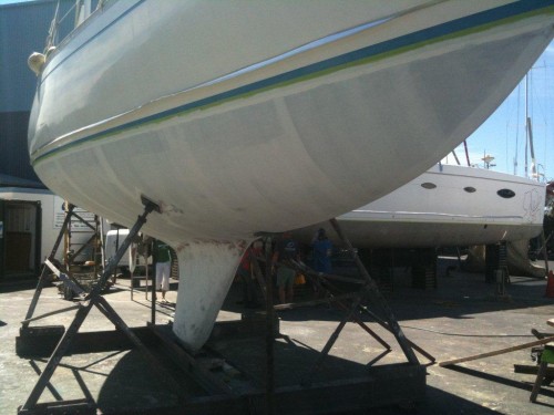

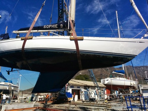

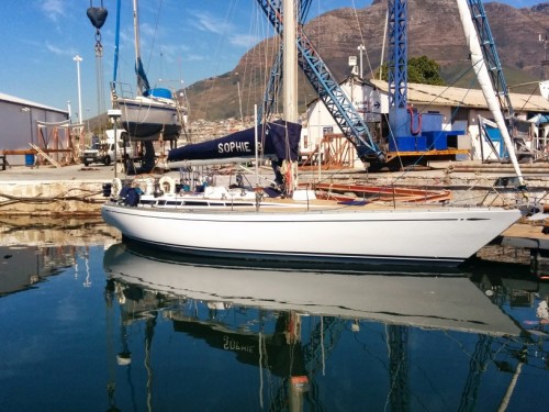

Wow. Bizarre. My brother and I have an offer in on the boat: great sea trials conducted this morning in Table Bay. Just waiting for the final report from the surveyor.
Hardly looks like she went through Fastnet '79. Here are some photos of her being lifted out for her hull survey today....

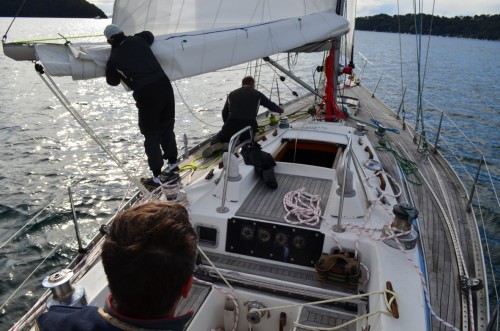

I'm very pleased to report "Scotch Bonnet" is pretty much back to full health. We just need to install a further 8 of the 9 Hella LED cabin lights, work out an attractive way of mounting a tall thin Origo stove in a space meant for short wide ones, and install the new Hella LED nav lights. Other work when time allows will be to re-leather the steering wheel and continue with varnishing. The one big job is to get the cabin table restored or rebuilt..... and then do some sailing!
Andrew "Scotch Bonnet" 41/039
Test sail with mast builder and sail maker

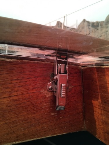

it took a few years but with our new front hatch perplex I now followed your suggestion and installed the same Protex fasteners. They fit perfectly and they close the hatch in a much more secure way than the previous solution. Installation is very easy because they can be adjusted after the installation. It will also be easy for our kids to use them.

Please can you advise where to obtain these fasteners?

the model is Protex (part nb 61-1610). I bought them via protex.com . There may be a cheaper source, so it is worth googling - I was a bit under time pressure.

Many thanks, and have you made your own catchplates or are these also from Protex?
i imagine when open, they stick out further than when in the closed position?

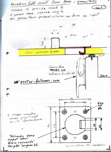

I will try to post the drawing of the catches I had made some years ago to go with the protex. Hoping they will be ok to read.

Our catches look like on Philippe's drawing. We already had them on the previous perplex, and reused them on the new one.
