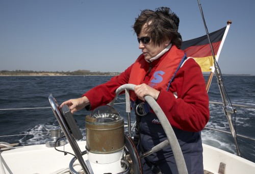

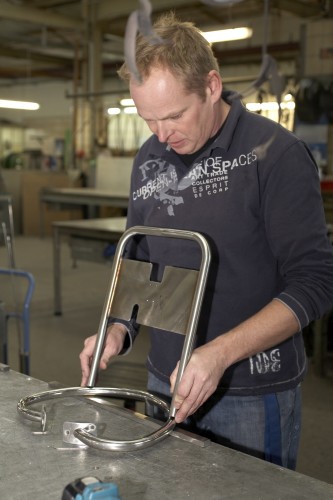

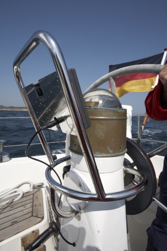

Hi Geoff,
on our 38/Carissima we added a small frame to the original horizontal steel grip around the stearing pedestal by welding. We use it for a chartplotter since three years.
Best regards from Hamburg
Klaus

Hi Klaus,
it is a very nice and handy setup indeed and it invites us to replicate it but I have a question. The distance from the compass to the instruments is pretty small: did you happen to check if there is any magnetic deviation when you turn on the instruments?

Join Date: 01 September 2007
Posts: 16
Hi Daniel,
indeed, the position of the chartplotter is really close to the compass because we tried to keep as much space as possible of the cockpit. Before we started building we checked very carefully any influence of the electric to the compass, but we found nothing. Our chartplotter is a NAVIONICS GEONAV 7wide net. Other electronic devices may cause more effects.
Best regards, Klaus

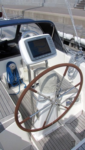

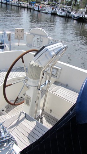

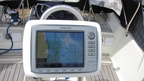

Hi Geoff,
Indeed, it is pleasant to have some sort of navigation equipment handy at the wheel. I added a Lowrance with Navionics charts and radar. very handy. I had a special made rack that fits quite well whilst the box for the Lowrance is from NavPod. The cables are nicely routed inside the tubes and no interference os noticed with the compass. Here some pics.
Cheers//Philippe
