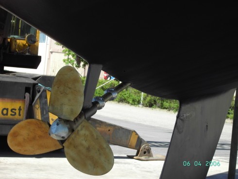

Hi Adrian
I definitely recommend a maxprop three blade. It works just fine. I also suggest that you learn how to put it together yourself. it is easy and strait forward. These things are far too important to let some pseudo engineer fiddle wrongly with it. The manual is very clear and once you have your parameters, the rest follow.
Here is a pic. Cheers//Philippe

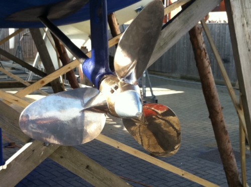

Many thanks for the responses.
We need to replace a maxprop and eventually went for a featherstream. (Corrosion problem had damaged the maxprop).
Just fitted all shinny and new!
Back in the water in 2 weeks, so we will see how it performs.
