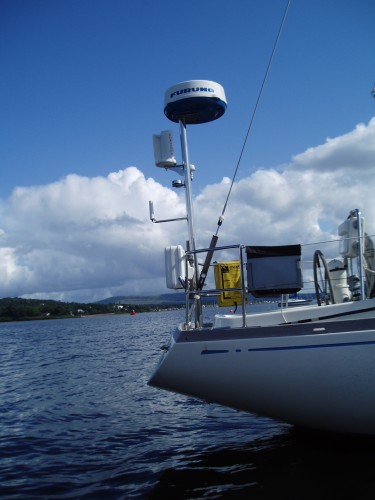

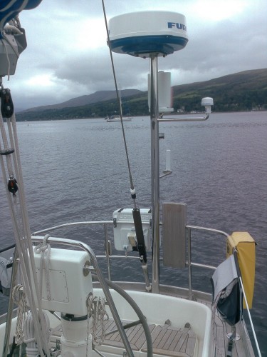

John, many thanks.    As I have a radar pole right in the centre of the aft deck, i.e. the 12 inches between the cockpit coaming and the stern toerail, I am concerned that the vane might hit it when it tilts forward under certain wind conditions (see photos).     The long protuberance projecting aft with the Navtex aerial has since been removed and the little wind generator will also be removed (too little power for the trouble) but that still leaves the pole.    That too could be moved to port but might still get in the way.    I have thought about a Scanstrut backstay fitting for the radar dome but the dome would still have to face aft so as not to foul the mainsail or get caught in reefing lines.    Roughly how close to the backstay does the vane come when right forward ?
No rush, this is going to be a next winter project.
Richard

Richard, if you look closely at my picture you will see my pole has been dropped to fit into the workshop. The pole fits to the side, but when the vane is used for dead down wind it does touch the pole (something I never considered when fitting). So this forces me to sail just off dead down wind on one tack. I am looking at getting the stubby vane which has the same surface area, but is shorter. The tall vane clears the back stay.  The Hydrovane is expensive, very easy to fit and use, the service and support very good. I also fitted my stern light to the pole giving it more height, therefore easier to see! My radar scanner is up on the mast.
John B  411/010

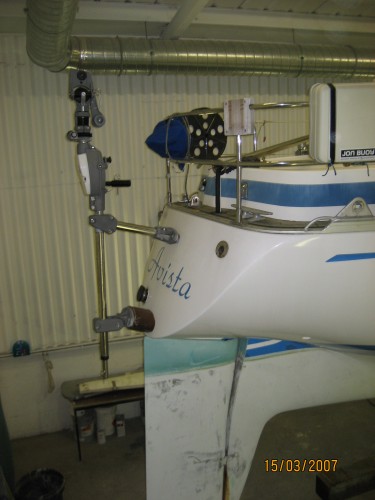

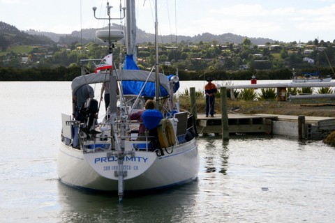

Hello Richard,
We have a Swan 41 and are long distance cruising in it. Our Wind Pilot Pacific Plus has faithfully steered us from San Francisco to New Zealand. We have never had a bit of trouble with it, and we both operate it. We have no lines in the cockpit to trip over or chafe. It's a good machine. You might want to have a look at a thread I started here in December 2010 titled "Long Distance Cruising in a Swan 41" I posted a pretty good photo of our unit. Let me know if you would like others - we have a few. For technical questions, I would recommend contacting Peter Forthmann in Hamburg (on the Windpilot site), as he is very helpful. Our radar mast has never had a problem with the pilot, and when we were looking to install, Monitor advised us that the radar would be a problem with their unit. Fair Winds. Rod Lambert

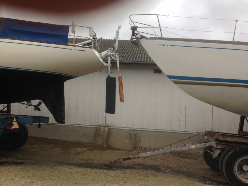

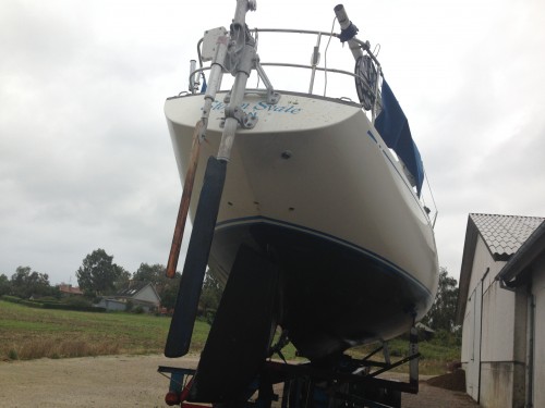

15 October 2015 - 07:09
Hi Guys,
An update on our experiences with the Wind Pilot Pacific Plus. We have just completed an Atlantic circuit with one, sailing from Denmark to Martinique via the Canaries, Cape Verdes, then up the chain to the Chesapeake where we over wintered and finally returning to Denmark via Bermuda and the Azores. In all we sailed around 18000 NM using a Wind Pilot Pacific plus for the majority of the trip. The only problem we had was when we were rubbed by a False Killer whale which cracked the rudder post causing the rudder to break off. Can't blame the Wind Pilot for this. Anyway, the WP and Storm Svale make a great team. The WP steered in 2 Beaufort 10s as well as down wind in less than 10KTS of wind. It is an amazing unit, it's value being reinforced when we had to shift to the E pilot after the whale incident... I do not like it in the harbours of Europe but for offshore it is quiet, uses no power which is a huge plus and steers in everything except no wind. I would not go offshore without one.
Fair Winds
Mike
Storm Svale with Wind Pilot
Storm Svale and Ophelia ready for Winter TLC
