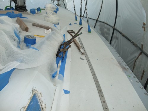

Hai Gavin, there is a 65 who just cut the upper part of the Toerails leaving the lower plate in place and covered it with teak .after one year only they had to do the job again. The problem is due to the high corrosion underneath the lower part of the Toerails. Next time I will be in the yard I will take and post some pics of Toerails to show you what I am taliking about. I also thought that the toerail was structural but if you check in the forum my previous post you will see the answer from the professor who says it is not. Therefore I exactly did what suggested by Lars . I replaced all bolts and nuts ( in total, both sides they are a little bit less than 400) with stainless steel ones A4 grade. This was the boring and difficult job because it means that you have to take off everything on the inside to be able to reach the nuts. Once the bolts and the trail are off you have to clean all holes with an 8 mm drill. I then put the new bolts in place with small washers and black sicaflex. I used semicircular head bolts with Allen key head to reduce the hight of the bolt on deck. Then all head bolts on deck were painted with a special primer for stainless steel . On the teak toerail I cut a slot to fit the heads . The lower part of the toerail which stays on deck as been painted with primer as well. To secure the new teak toerail to the deck ( next job to do ) I will use longer bolts to make it strong. The idea is to use longer ones every 40 cm.

Gavin, pease find attached a picture of the new bolts.
the new teak toerail will sit on top of it. it will be machined to fit the bolts.
hope this helps
