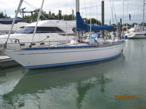

I have a permanently fitted furling staysail on my 411. Has anybody got experence of how to set the correct tension. I start by releasing the tension on the back stay then tighten the forestay, but have problems getting the correct tension on the staysail. As soon as I harden up on the back stay to tighten the forestay, slack develops on the stay sail.   Should I over tighten the staysail in the first instance?

Guys, thanks for your feedback. With the yacht level on her marks I set up 9 inchs of rake measured at the goose neck. I achive this by sliding the mast step backwards or forwards, the axis being the Spartite at the through deck mast collar.  I then tighten the rig down. Any further rake and bend is achieved by tension on the backstay.  I am not sure how you can get any pre-bend with inline spreaders. When using the staysail I always use the checkstays to support the rig. I also use them when hard pressed upwind and the rig starts to pump. I tighten the backstay to increase the tension on the forestay, but as Lars suggests never more than the top of the mast bending back a further 3 inchs which is approximatelly 50% of the diameter of the mast. When sailing in Force 3/4 this gives some weather helm normaly one spoke of the wheel. I can remember Olin saying more than 2 spokes of weather helm and your either overpowered or the rig is not set up correctly.  Normally the lee rail is underwater with 2 spokes which then is definately slowing me down.
Lars, I will check the pressure I put on with the hydrualic backstay. From research I did, I understood that the staysail had to be parallel to the forestay, which is what I have achieved.
