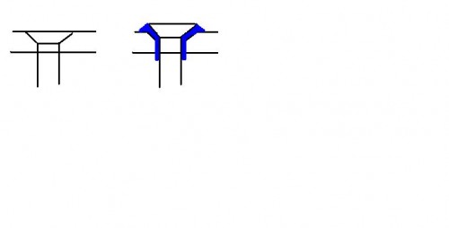

Galvanic corrosion around the screws can be stopped and small crevices hidden by adding plastic washers that prevent screw to rail contact, and cover an area around the screw head. The washers also lift the heads above the surface and keep them drier. The screws need to be taken out individually and the washers added, a tedious job.
Enclosed a sketch.
This is a proposal and I do not know a supplier.
Kind regards Lars
