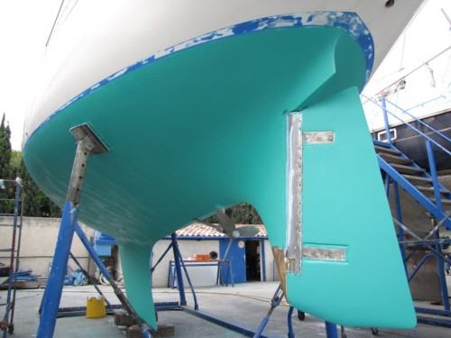

I am not sure about the 47 but on our 41/022 the leading edge of the rudder is indeed hollow since it is made of a stainless steel sheet screwed on the front part of the rudder and hiding hinges and rudder stock. Please see picture below taken during osmosis treatment.
Regards, and good luck for your hull repairs.

Hello! I am not sure about the 47 but on our 41/022 the leading edge of the rudder is indeed hollow since it is made of a stainless steel sheet screwed on the front part of the rudder and hiding hinges and rudder stock. Please see picture below taken during osmosis treatment. Regards, and good luck for your hull repairs. Philippe
Dear Philippe
Thanks, that is reallyreally helpful. On this basis I think I can save a lot of time and unnecessary work
