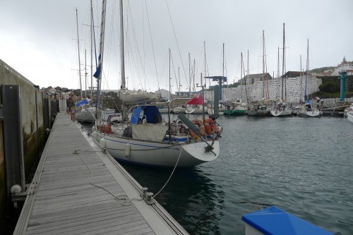

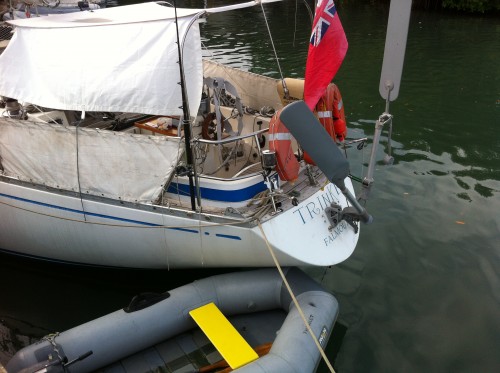

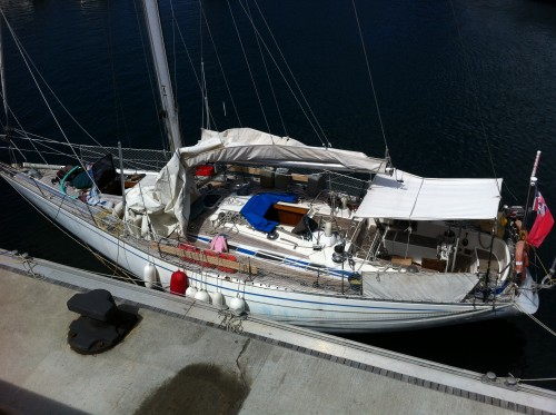

 Attached are some photos of my solution. The awnings are based on two frames, one right aft, and the other just under the boom . The frames attach to the toerail with special clamp on feet, and can be removed entirely. The feet consist of a piece of stainless plate about 6" long that is machined to fit tightly on the inside of the toerail. The feet are clamped with two M6 bolts that pass through the large holes in the toerail. I used large plywood washers on the outside.  The feet have sockets for 1" tube. The frames are 1" tube made in sections. The forward frame has guy ropes to the toerail. The aft frame ties to the backstay.
 When using the front frame, the mainsheet has to be transfered to a rope strop round the boom about 18" forward of the normal attachment.
 The aft awning/bimini is a simple flat canvas sheet stretched beween the frames. It has zip on side panels that tie to the guard rails.  The front frame also supports a larger awning that fits under the boom for use in port.
We have used the bimini for many thousands of miles without trouble. With the side panels, it serves as a rain and wind sheler, as well as a sun awning. The only problem is that shifting the main sheet forward on the boom means that the mainsheet interfers with the use of the genoa sheet winches.

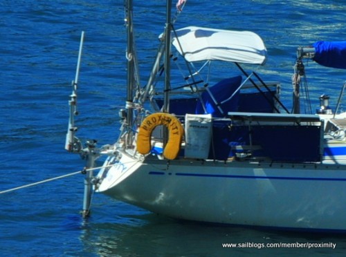

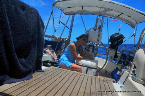

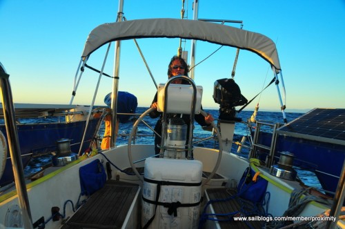

Join Date: 10 December 2010
Hello Philippe,
We installed an "off the shelf" bimini, but had to do some modifications to it to get the job done. This was only to keep costs down. To do it it nicely, you could custom order it to fit. For cruising, we had installed a stainless rail to hold the solar panel. It is mounted on the stern rail and to a riser coming from the closest stantion. The bimini is mounted on this rail. Nothing on the original boat structure has been drilled or cut. Since it was an off the shelf model, we trimed the tubes to fit what we needed, and then my wife trimmed and sewed the canvas to fit. It has nylon straps that keep it tight and stiff that we simply tie to an unused cleat. We have sailed from San Francisco across the Pacific to New Zealand and then on to Vanuatu where we are now, and have had absolutely no problems. We have seen some big blows. Our blog has many photos if you would like more views of it. www.sailblogs.com/member/proximity Good luck with your project. As I said, we drilled no holes or made any changes to the original boat, and we can take it away any time.
