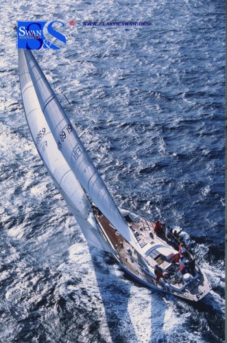

I have thousands of pics os Swans (as you can imagine...!)...but the only one of a 48 with the teak deck well in sight is the attached one, taken from a heli to Kia Ora (extended transom), hope it helps!
