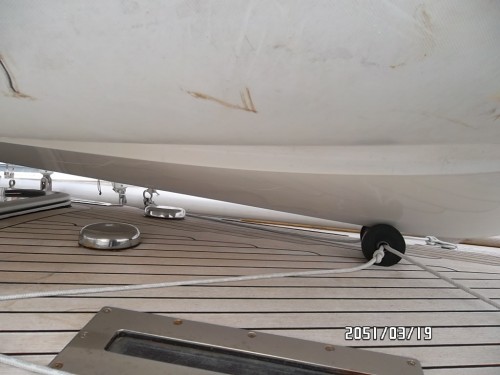

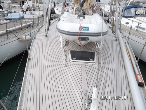

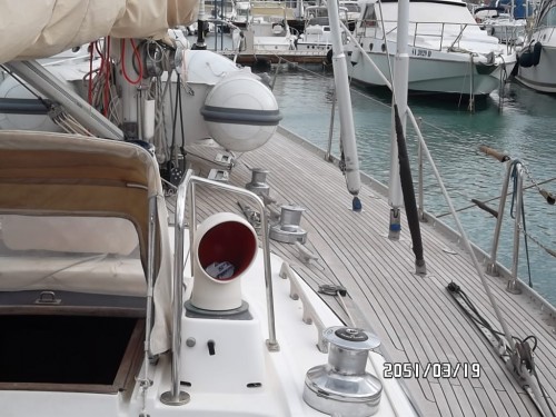

Thank you Chris,I have a 8'6" RIB and I leave it on the foredeck.
I arranged to apt a light 2" pole from an old mast of a Laser for hoisting it. I am glad with it.
Maybe it is better to show through the pictures, you can see the pole on the side of the spinnaker pole.
Please note too how the foredeck has been changed from the original design.
FW Matteo, Grampus 47\016

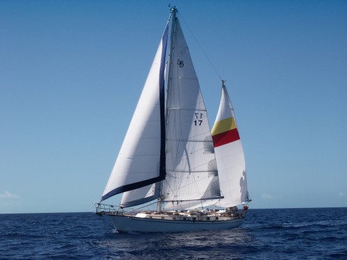

Thank you for your note. I have had similar experiences around even small capes. One time, off the northern cape of Long Island in the Bahamas, with full sails on my Shannon 50 flying, picture attached, the wind doubled from 12 knots to 25 - that was a true scramble!
On another occasion, we left Saint Lucia, dinghy attached securely, we thought, until about 20 minutes into the trip I noticed that the dinghy was not in sight! A quick gybe and two hours later we found it!
Thank you for the advice.
