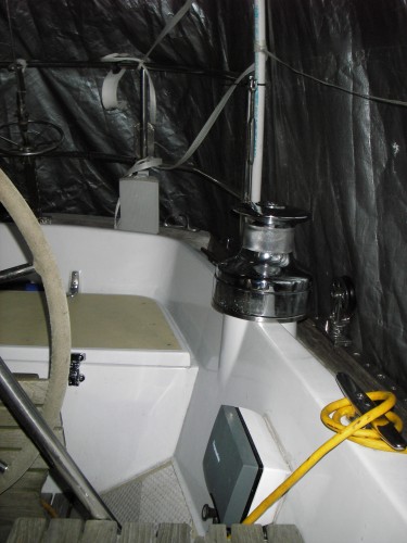

03 January 2013 - 19:16
Join Date: 03 December 2007
Posts: 10
Matteo,
Here is an old photo showing the stainless steel plate under the winch.  Cheeers!
--Rick McLaren
1970 37/17 Dulcinea
