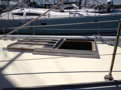

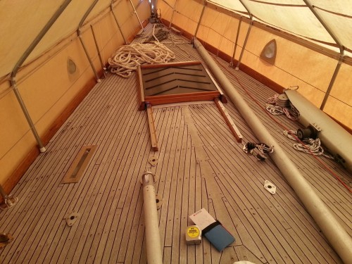

We are currently renovating the forward sliding hatch on my 43 (Firebrand II) and are currently debating over how best to treat the timber work.  We have had a lot of differing advice over what to do; everything from doing nothing, through oiling to varnishing.  The exterior parts appear to have been allowed to weather naturally (see below) while the  non-exposed parts appear to have been varnished at some stage.
I guess the same goes for the teak toe rail (the teak decks were long gone before my time).
Andrew

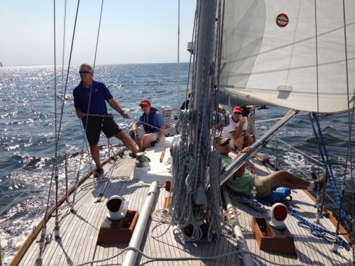

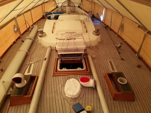

On my 43 I have been using Cetol "Teak" with clear coat on the teak work on deck.
I realize that this may be upsetting for the purist and I understand but I race my boat often and the the bright work takes a real beating. The Cetol is much more durable and easier to fix and compared to varnish much less maintenance. See the attached photos.
Good luck with whatever you decide.

Thank you for your responses.  Hiro, the photos of your boat provide a fairly compelling argument for oiling or varnishing.  Your bright work looks very smart and it's great to see how another 43 is set-up.
