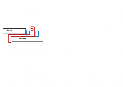

No suggestions so far, but I would like to come up with one. Requires that there is a slot between the hatch and the garage above it, enabling a steel bar to be inserted. The bar has a 90 degree bend at the end. The bent part is horizontal when inserted, but turned down to vertical when it has passed the hatch edge, and then prevents the hatch from opening. A padlock is attached to the bar outside the garage, and arranged so it prevents the bend from turning horizontal. Maybe a sketch would be helpful?

12 January 2013 - 11:15
Dear Tony
Here a side view of the suggested locking arrangement at the aft end of the hatch.
The thickness of the hook should fill the slot between the top of the plexi and the garage above it. If the slot is wider at the plexi edge the hook vertical part needs an extension upwards.
When the hook has been inserted into the slot and turned vertical the outside transverse piece is put over it, a recess and a hole for the upstanding part is needed. The transverse piece secures the hook in vertical position, and needs to be long enough so it can not be forced into turning the hook horizontal.
The outside hook part protruding above the transverse piece has a hole for a padlock. No parts need to be attached to the hatch.
SuperSecure version could have two hooks joined by a longer transverse piece.
A plunger lock comes close to the edge of the plexi, and is probably fairly easy to break loose.

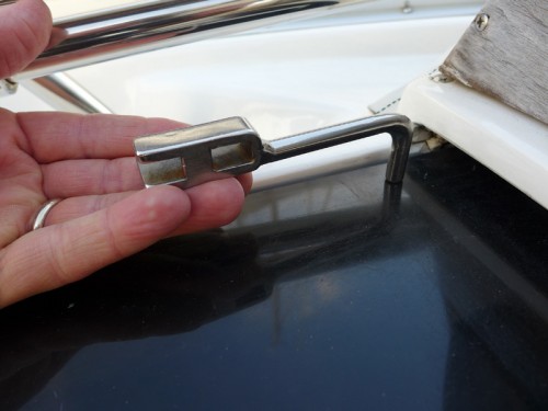

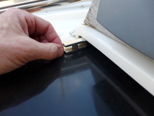

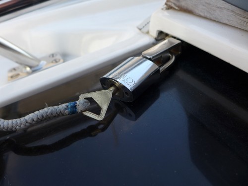

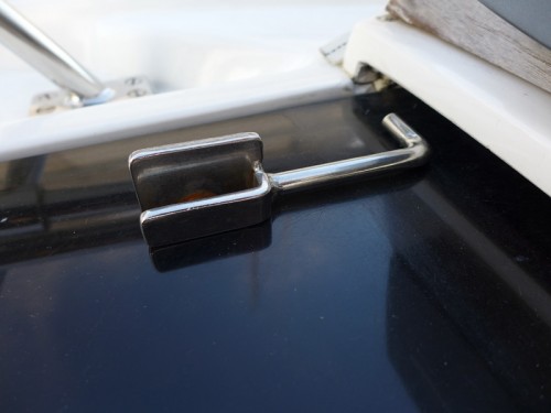

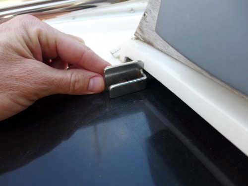

I have the original Nautor lock, and it's exactly as Lars explains in his reply. Unfortunately I am not going to the boat for the next three week as I will be in USA, but as soon as I will be back in Italy I will get detailed photos and will post them.
10 February 2013 - 20:46
Dear Tonyh,
here you are, I am attaching JPG's of original Nautor stainless steel locker:

11 February 2013 - 06:09
Join Date: 20 March 2011
Dear Matteo
Thank you for taking the time to take & post the photos. They make Lars' drawing perfectly clear, and I will have one made up
