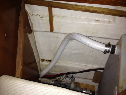

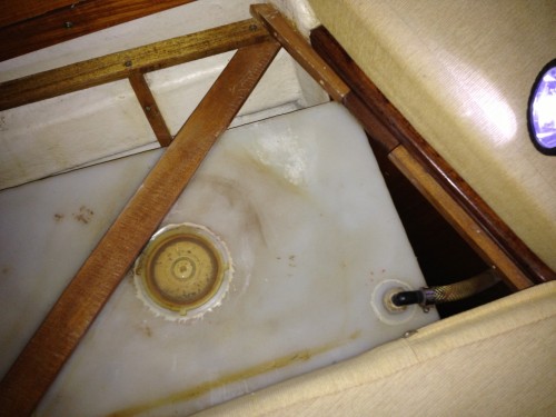

03 February 2013 - 19:20
Join Date: 28 June 2007
Posts: 15
Hi Tom, sorry about the delay, I just got back to Athens. Attached in two messages are the pictures of my holding tank under the front port berth. Let me know if you need more details
Best
Constantine

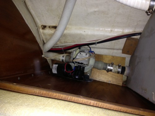

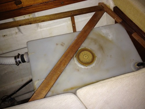

03 February 2013 - 19:23
Posts: 15
Hi Tom part 2
Constantine
