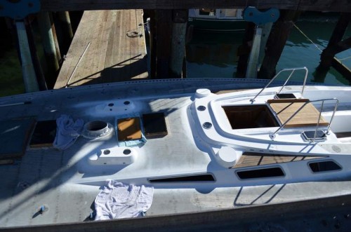

I am sure that I have seen a post about replacing the acrylic windows, but I cannot find it. As we are painting the deck moulding,we decided to remove the covers (are these GRP?) and windows. They came off very easily, the mastic not bonding to the acrylic at all. The original windows are almost opaque now, and I would like to replace them. The choice would be toughened glass or acrylic. I favour toughened glass, however there may be disadvantages with fitting this. Any comments please.
