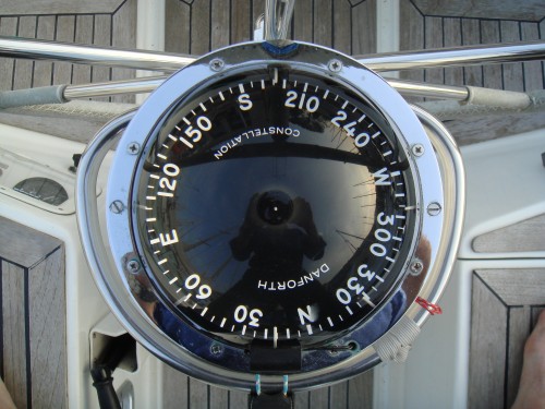

as you are planning to be in the Med, you can consider to send the compass to Fuselli, in Genoa. I sent him mine, about ten years ago, he rebuilt the glass and restored everything, it's still like new, will post a picture later tonight.

11 March 2013 - 21:39
Dear Fabrice,
here you are!
pic taken 2007, job done ten years ago (still in same condition)
