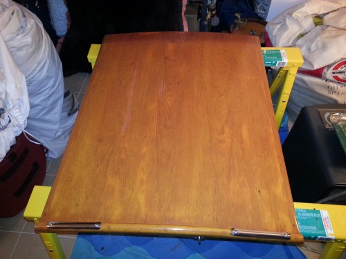

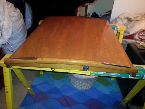

Thank you for your reply. The bad condition of my sliding hatch compels me to think about working on it sooner than later. This likely means, at least for this year, fixing what I have. Would you be able to send a picture of your hatch so I can compare to what I have. As I mentioned, there have been modifications to my boat, some good, and many not so good.

Here's my companionway hatch.
Hiro

Dear Hiro,
Thank you for posting the pictures.  Yes, that looks like my hatch, albeit in much better condition.  So, I think I will remove it, strip it, and add a new layer of teak veneer, and paint on 10-12 coats of varnish!
