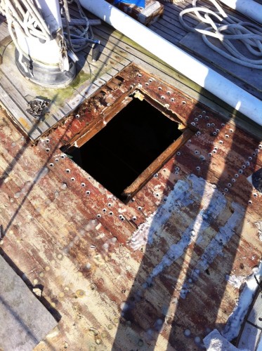

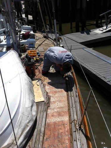

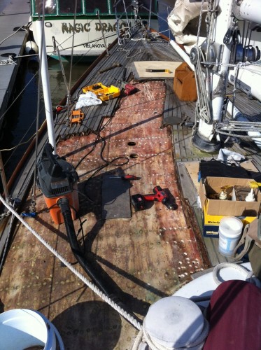

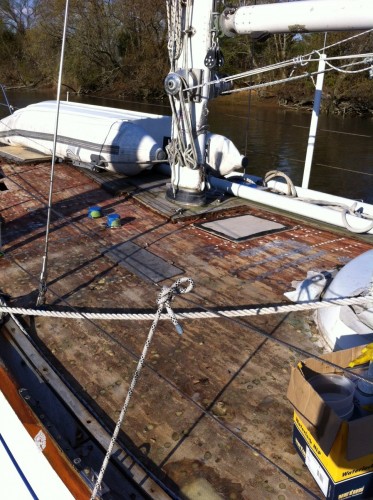

22 April 2013 - 15:19
Hi Hiro,
Thank you!  I may give Roger a call.  In the meantime, as you might have guessed, the Professor has been guiding me throughout the entire process and prove, as always, invaluable.  I feel like I might even make it through - let's home the Professor can continue to show patience in the face of my barrage of questions - some good and others...more obvious!
Anyway, attached are pictures of our progress.  The water intrusion is killing me!
