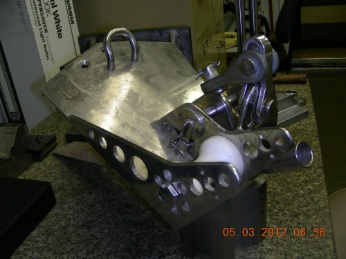

I discovered a little crack in the welding of the part of the bow plate (correct name?) last fall which holds the furler... I am then trying to find all the missing components... while getting it refinished. In doing so I always wanted to figure out all the detail of nuts and bolts missing above the roller.
Is there any drawing and or specs. available somewhere..or can someone send me complete photograph survey of theirs, please?
There is a notch on the nut head of the roller axle, I am sure some additional hardware was designed like a stopper of some sort... there is a thread on the upper part, it probably retained the body of the anchor ...
Any help would be greatly appreciated.

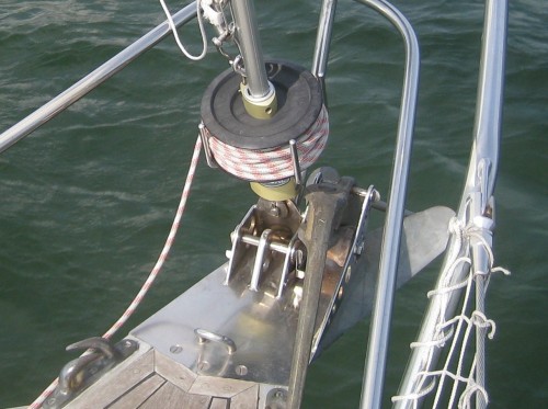

Dear Vincent,
Attached please find a picture of the stemhead of the Infant. There is, as you suggested, a bolt locking the anchor on the roller. The bolt can not be drawn out of the outer (starboard) hole. If you need more detailed pictures, I can send them in a week or two.
Jyrki (Infant 38/014)
