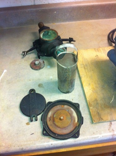

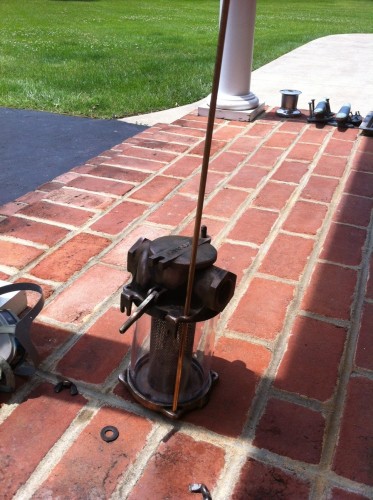

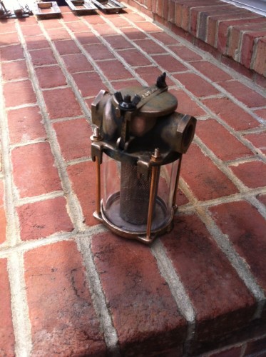

I cleaned the the Perko strainer this week and threaded bronze rods to fit.  i also replaced the cast acrylic cylinder.  I purchased the parts from McMaster-Carr and used a Sear tap and die set.
Here are pictures for those interested.  I can provide further specs if desired.
Fair Winds and dry hulls
Strainerench Parts on workb
36 inch 1/4 inch bronze rod with one end threaded
Strainer complete
