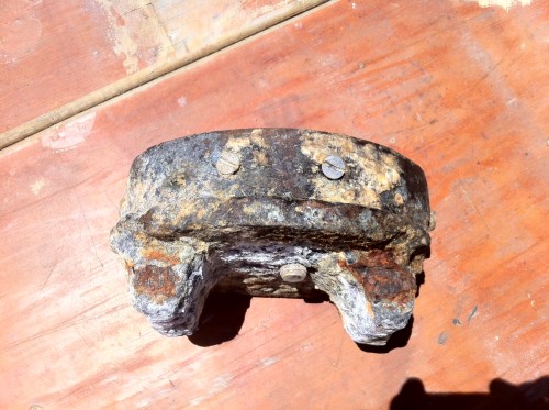

We now just have to rebuild the bottom of the mast. I know this has been covered before but does anyone have any ideas where we could get a smal section of the original mast section? Or any other section that is available that could be similar and bent or made to fit?
I have attached a photo of the Base plug from the mast which is so badly corroded we will have to replace it. By any slim chance can we still buy them? If not anyone have any ideas? I saw one get replaces with G10 plate on the forum, that might be our best bet.
Thanks
