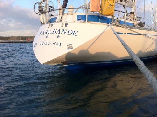

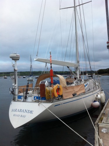

I replaced my rig with a painted mast and boom in Awlgrip Off White. It is not the same as the hull, but near enough for me and blends in very well. Being in the air and some distance from the hull, you do not get the direct comparison tho. I have also re- gel coated the Transom - a fantastic job done by my local yard and you would struggle to see the join!!
Best of luck with your project.
Rob Mably.

Dear Chris, thanks a lot for your quick answer. No doubt about the forum: you are already a proof of your nice comments about the members.
I received some advice that the mix of 50% snow white to the Off white was "bringing too much white" (so to speak...) compared to the original gel coat color, hence the question to the members to reassure me. I know in the end it is a matter of personal preference and taste but I'd like to get some feed back and eventually pictures on the 50% mix.

Thanks Rob!
I was not already thinking of the mast, but the idea is interesting actually.
Did you paint the original Nautor mast?
Did you upload on the site some pictures of your transom repainting and your mast? I'd be really interested to see the outcome.
Matthew

My feelings about paint are only do it if you really have to. Gel coat is by far a better surface for the hull, more easily repaired and I think looks better, that is why I went to the expense of re gel coating the Transom instead of painting it. I hope never to have to paint the hull.
As for the rig, it is carbon, and I just didnt want a black rig. Protecting the paint on the rig requires rethinking where you stow your halyards etc. I dont think I would consider painting an alloy Nautor mast, it would be very expensive to do a really good job I would think.

Thanks for the picture Rob. She is beautiful.
Agree with your comment on the gel coat, but you're lucky if you actually still do have a nice one after 30 to 40 years. In our case, unfortunately, the many years of polishing (among others) were not really giving us so much choice. I might go for a new gel coat at a later stage. Let's see.
