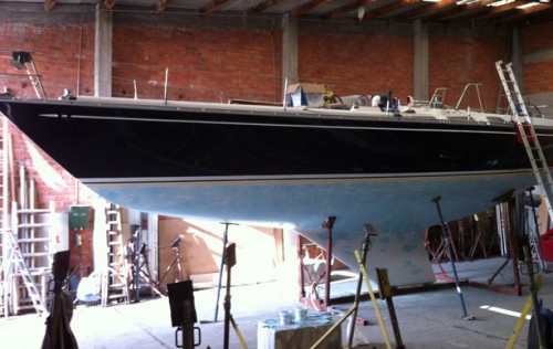

What we have done so far:
1. Pealed of the Gelcoat (osmose treatment part 1) and hull dried for 9 months
2. New navigation corner
3. Some interior refit (paint jobs)
4. Keel fairing & shaping
5. Sanding the hull (above waterline)
6. Painted the hull with 2-component paint (3 layers)
7. Epoxy treatment below the waterline (osmose treatment part 2)
8. New toilet
9. New dorades
10. New clutch
Todo's:
1. New antislip on deck
2. Antifouling
3. Mounting radar pool
4. New navigation led lights
5. Mounting propellor axe with new bearings
Astimated launch is second week of june.
If anyone is intrested please teake a look at: www.repoman.be

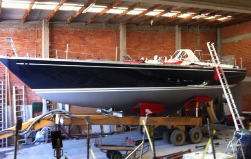

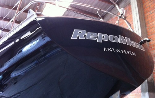

Paintjob

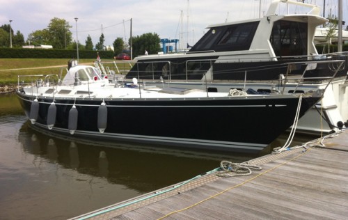

At the moment the boat is launched:
latest pictures:
More pictures comming soon on www.repoman.be

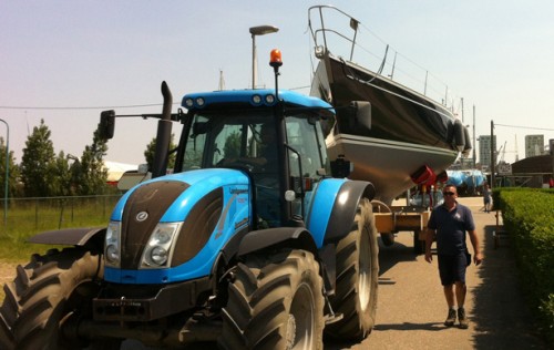

Lifting carefully
On transport to the dock
Nice fender socks ;)

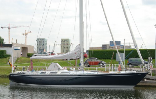

Lots of work and new pictures:
- New roller system for the genua: Profurl R420
- New roller system fot the cutter: Profurl NX 2.5
- New forstay and backstay (dyform 10mm)
- New Navtec pump for the backstay
- New Scanstrut radar pool
- ...and Lazy-bag :)
Stay tuned at: http://www.repoman.be
Stepped the mast
