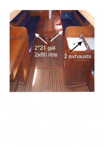

Also I was wondering about how the freshwater tanks are supposed to be. At the moment we have some plastimo soft bladders on the starboard side under the bunk. Does anyone know what was the system originally?-----------------------------------------
Hi, Fletch.
Under the bunks in Swan 37/12 there are two inox tanks for fresh water, each 21 gallons (80 litres)and the exhausts are over the galley sink.
Kimmo

Thanks again for the info and your picture, we will plan to put the water tanks back how they should be!
