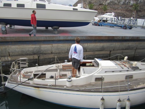

Wise people of the forum! I have more questions.
So I bought the Swan 37 #55 on reputation alone. Never having sailed a S&S Swan, and this one was not in a state to take her for a test sail. I have no doubt she will be a dream to sail.
My question relates to the cockpit layout. The primary winches are self tailing the aft winches are not. There was three cleats on the top of the coaming. What are they all for? I can see how the aft winches not being self tailing would need a cleat but what are the oher two for? They are all off now in order to paint the deck but I am tempted to leave off the forward two cleats if I cant find a need for them. I am guessing they could be useful to hold lazy sheets and the furling line ect?
I have attached the best picture I could find of hte cockpit as it was before, sorry its not a great photo
Thank you!
Fletch
Swan 37#55 (no name yet)

Sorry the photo didnt work first time

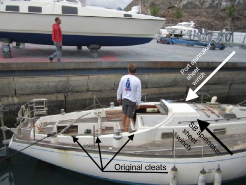

Hi, Fletch.
If istalled, 37 has spinnaker sheet winches located on cabin roof. The three cleats were ready for three lines. Sailing her now, one is enough.
Kimmo
Thank you!
Fletch
hi! looking forward to see to some pica of the result of the restoration! we stil a 37 now for about 25 years and the first most forward clamps removed make joystick steering sitting on the side much easier; good view on the matter and genua telltales, and main sheet access. the others come in hand for indeed lage sheets, mooring (spring lines) and when changing sheets (inner/outer) of the genua.
