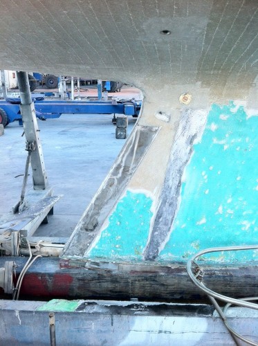

Our keel had fibreglass down the trailing edge that had delaminated. I stated grinding and was surprised that there was fibreglass between the lead and the stainless trailing edge. It looks well made and like it is supposed to be there, Lars or anyone else could you confirm this? Nearly all the fibreglass was detached and had water behind it, I am happy to remove it and plan to re laminate as it was before.
Just posting partly out of curiosity and thought Id put  up a photo incase any other owners wanted to see the detail of the keel trailing edge as I couldnt find one on the forum
Fletch

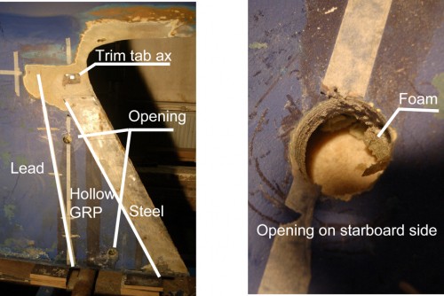

Hi, Fletch.
According to The Professor some yachts had a trim tab(small rudder) attached to the trailing edge of the keel, and due to new racing rules later removed. In 37/12 the hollow grp was filled with foam, which after 40 yrs was very wet, and was removed thru large openings on both side of the keel. Knocking on the grp sound gives an answer, drilling too.

Thanks Kimmo!
I knew that various models of classic Swans came with a trim tab but had no idea that some 37s had it.
I will drill some holes in the GRP to see how things are regarding the water.
Great info, Thanks again!
