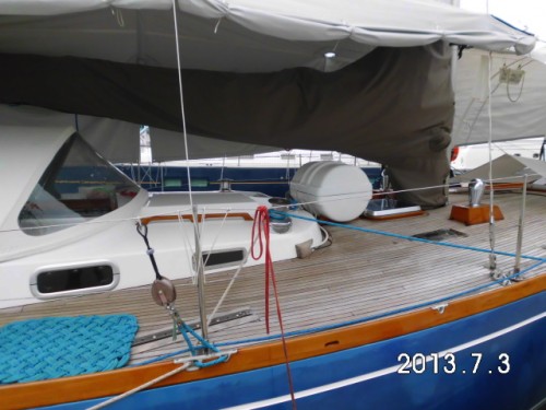

Hi Chris,
I have 2 vertical gas bottles in a life raft container just aft of the main cabin hatch.  I found a container that had the height I needed then shortened it by cutting a slice out of the middle.  The gas hose and the solenoid cut-off wire come out of a 25mm hole in the bottom (which is big enough to allow leaking gas out if ever) and into the boat on the aft side of the main salon/galley bulkhead.
I changed the sliding hatch forward for a non-slider, which gives me deck space for my real liferaft (which you cannot see because it is not aboard at the present time).
One other change from original 43' you will see in the photo is the opening portlight in the galley; I changed both port and starboard to give air while in the galley/chart table area.
This gas system has never been a problem for us.
David  43/12
2 gas bottles aft of the mast

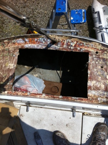

The problem I am now confronted with is the large hole in the deck that housed the propane container.  It's a rather large hole, I will post pictures next time, and I am also concerned that it has jeopardized the integrity of the hull.  So, I have come to the realization that work will need to be done to sure up this part of the deck and that rather than completely rebuild it.

Attached is a picture, which is also posted under the forum thread re toe rails, of the propane locker hole at the stern of my boat.  My concerns are that the size of the hole may have compromised the integrity of the stern are of the boat.
Professor, maybe you have an opinion.
I also don't like the fact that so much of the limited storage area is taken up with propane storage.  I don't plan to live aboard anytime soon, if ever, and would like to install a much smaller propane tank so I can use this locker for storage.

The backstay load is aligned with the transom, this means the transom conveys the load to the side decks, and the deck forward of the backstay chainplate is not highly loaded. Suggest you check the aft corners of the opening for cracks, if there are any, reinforcement is recommended.
A question referring to the edges of the opening - is the deck of sandwich construction here, with a foam core between two GRP skins?

The deck here, as elsewhere on the boat, is not cored.  I do not believe, however, that the stringers are present here as they are elsewhere.  There is a little delamination which I will repair.
This is what I would like to accomplish:  since the hole is there, and you have made me feel much better about the impact it has on the integrity of the boat, I would like to use it for both a propane locker and for storage.  Ideally, I will be able to locate a long, horizontal propane cylinder which could be captured in that area and also allow access.  In the current setup, the propane box was glued and screwed to the deck so there was no way to get easy access to the area around it.  Further, I don't need a 20 pound propane container; 10 pounds would be perfect but I would be willing to go for 6 pounds if I can find the right one.
I found a 6 pound vertical cylinder that had a 6 inch diameter but is tall.  If there is a place on the starboard side, I could build a box below the deck, glassed in with a vent overboard, and purchase an 8 inch hatch to allow access to the tank.  Then the current access hole could be used as storage.
I worry that with my limited experience using my boat that I will make a permanent change that needs to be undone!
So, thank you for putting my mind at ease about the impact of the hole.  And any further advice about propane location will be gratefully accepted.
