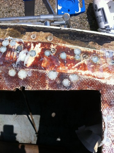

It will be a while before I examine the toe-rail and determine what needs to come off, however, I can provide pictures of the stern toe rail, which has already been removed, and the hull-to-deck joint.  I would guess that this construction method would be consistent for the rest of the toe-rail.

Attached to this entry are 3 pictures - one to follow.  Please let me know if you need more and describe what you would like to see and I will do my best to provide it.
Chris

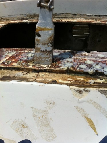

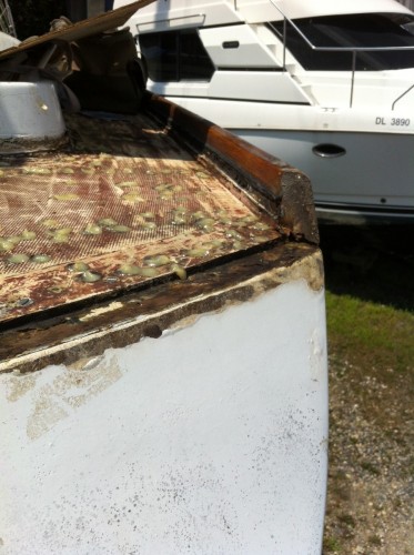

Stern - deck and flange
Stern - forward view
stern - forward view 2

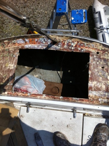

Propane locker and view of entire stern toe rail area
Stern Deck - cavity for propane locker

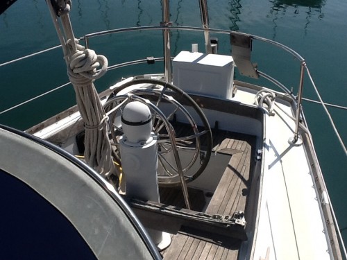

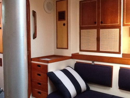

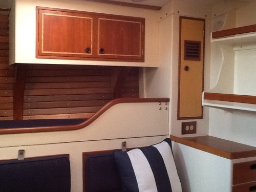

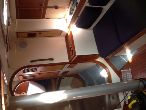

Sorry I have been so long in getting back to you. Here are some photos of my 43' REDECCA. I am currently redoing the cabin sole and working my way aft to convert the starboard quarter berth to a double. On the exterior I am going to have a new bow roller fabricated as the old one has a small crack in it. I'm trying to figure out how I might incorporate the ability to fly a code zero as well.
I have all but decided to remove the teak toe rail and replace it with a Goiot aluminium rail. I'm feeling very quilty about doing this!! Our plans are for cruising and as the teak deck is already removed it helps in making the decision.
Are you replacing your teak toe rail? I know you have the stern portion already removed.
I imagine winter has slowed things for you. Here in San Diego I can't use winter as an excuse for not being further along than I am.
Hope all is well with you.
John

Sorry for the long delay. Beautiful and clean work on your interior. I love it. Inspirational!
