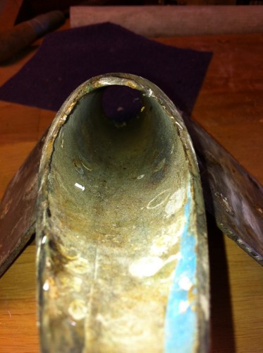

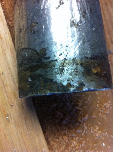

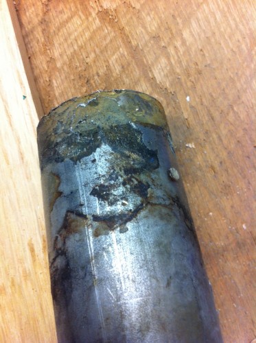

At the advice of the Professor, I removed my shaft log (this is part of a much larger project which includes entire new drive train) and recently sent pictures to him for review.  Here is what he had to say:
Professor:  "There is some pitting on the outside of the tube, this means water has been standing under the hose at the forward end for a long time. Maybe the hose clips were not tight enough, or the hose uneven, and the crevices not filled with mastic.
The term crevice corrosion refers to this situation when there is a narrow slot with water trapped inside, and this can cause corrosion on stainless steel as the photos show.
Finally and silently the tube would corrode through here, and this can be a catastrophe if it occurs at a bad time, could sink the boat if nobody is around.
Pitting on the inside of the tube has apparently not occurred here, this is feared more because difficult to see. Sea water is standing inside the tube, and if the water is not replaced there is a lack of oxygen with the time, and this could cause the same pitting. The water is slowly replaced when sailing, but if the boat is standing for a long time in a basin, possibly in polluted water, there may be hidden corrosion problems.

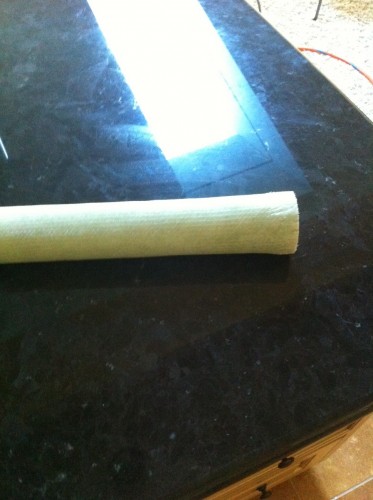

Your new GRP stern tube does not have these potential corrosion problems."
I have attached pictures of the removed shaft log to this note and will attach pics of the new grp shaft log to the next.

Top - interior connection
Bottome - interior connection
exterior - below waterline exit

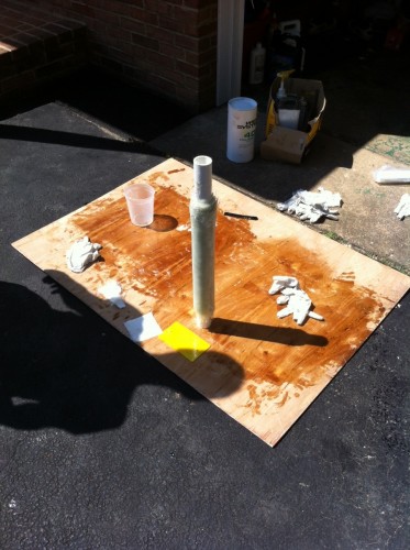

The new grp shaft log - not quite finished!
Very Valuable to have sons!
Drying on the mandrel
Finished product
