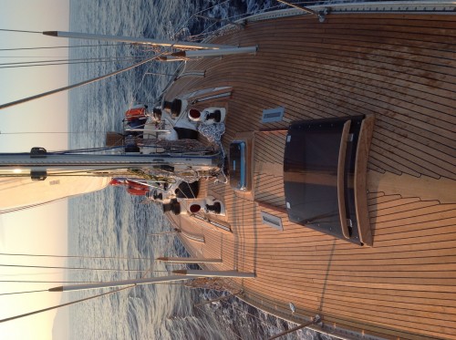

Sorry but i definitely agree with Matteo that on our S&S boats we should keep the originality even if we suffer a bit of hot temperature in summer. ;)
On our 44 we replace teak and all the 4 prisms easily by a Genoa plexiglass supplier .
Alberto
Pippus 44-011

Hi Alberto,
my complimenta for your beautiful deck!
Matteo, Grampus 47/016
