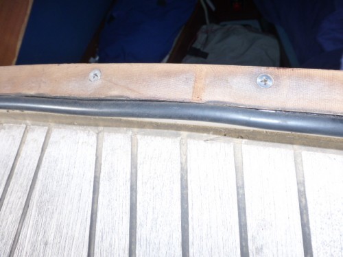

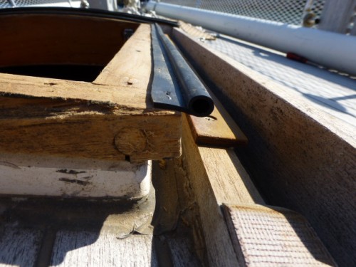

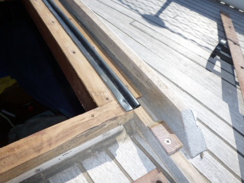

The front hatch was for me a symbol of the S&S.  When we did our refit we were able to change all worn out pièces of wood.  This is easy as every part can be dismantled and copied.  I had then the problem of the joint.  Nautor does not provide this joint anymore.  After a some research and after looking at this wonderfull site I found a "P" shape joint resistant to UV.
You will see on these picture how I put it.  Unfortunatelly I had to buy 20 meter so I have here at home around 16 meter left.
By the way the design of the hatch is so good that we sailed one year without the joint and still did not get any water inside.
This hatch system is just great.
