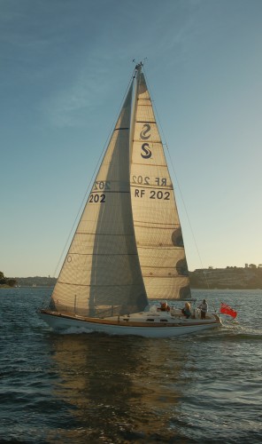

Hi, I believe its time that my yacht Bella Gioia dismantles the heavy original mast and replaces it with a taller light weight mast so as to improve her performance.
My question is is there a recommended taller rig(looks to me that 1.5m-2m would work and look a lot better) would balance her looks(the present mast does look a little squat).The other question is should I maintain the mast head rig or go for a fractional rig.Have a look at her sailing on the assoc web site.
Regards Ross Norgard

You are right that rigs are taller now. You could either stay with the masthead concept, or go fractional. In some cases the foretriangle has been retained, and only the mainsail luff extended. If the extension then is a metre or so you can probably still tension the forestay with the backstay, if you go higher the runners will be essential for getting a tight headstay.
There are various criterions for how much extension to choose - appearance, stiffness in a blow, light weather performance, achieving same characteristics as some known boat, etc.
Assume you will go to double spreaders, then the chainplate dimensions need to be checked as the load distribution in the shrouds changes, and different shroud sizes are probably required.

Sailing on the Swan river between Perth and Fremantle
