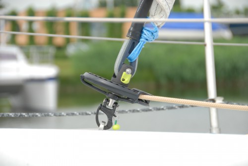

We use a Profurl NX 2.5 furler for our cutter sail. Cutter sail is hosted with a 2:1 vectran halyard. We do not use a stay.
When we use the genua only lowering the cutter sail is very easy, quick tacks are possible then.
