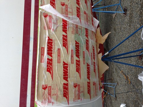

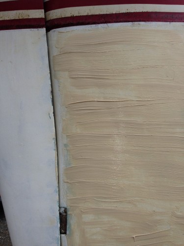

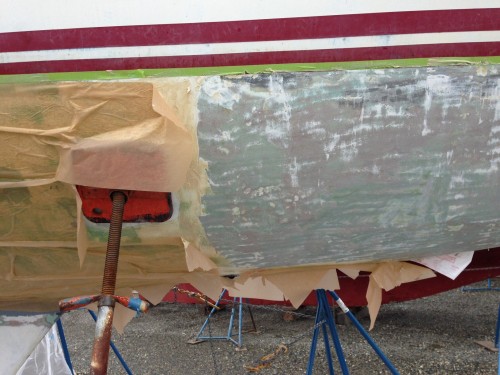

I am redoing the barrier coat and bottom paint on our 411/Zoe. I am using a product that does an outstanding job. It's call Peel Away Marine Safety Strip. Very simple process and clean up: roll on a thick paste, cover with paper, let stand for several hours, and peel off. Final clean up on the hull is with a sponge and water. I've enclosed a few photos.
Some of the barrier coat has also come off, which only confirms that it's time to renew the barrier coat.
Brushing works, but a paint roller was more efficient
Paper layer which keeps the stripper from drying too quickly
part of the finish comes off with the paper. The rest is easily scraped
