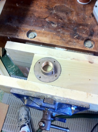

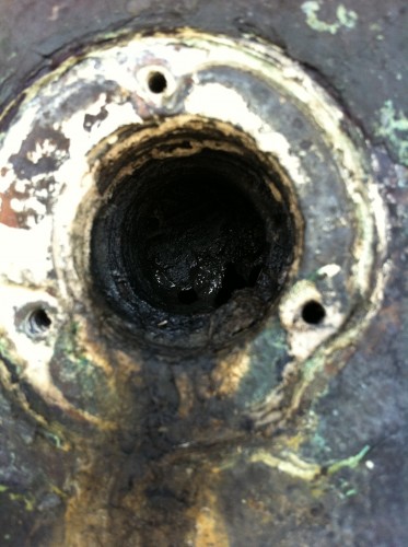

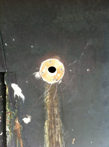

On my 43, I found a barely attached drain and drain plug that concerned me greatly; here's what I did:  Please see the pictures to follow on next post and the link to my blog which will give a better description.  And, if helpful, please contact me and I will offer any assistance that I can.
With warm regards,
11 November 2013 - 13:53
Dear Martin,
Here is a link to the page related to the garboard drain:  https://sites.google.com/site/mabelscassetete/home/below-the-waterline/garboard-drain-plug
And three pictures that may be helpful:
This is the original fitting - I was very worried
New Fitting and the router template
New Drain, sans plug, fitted to boat

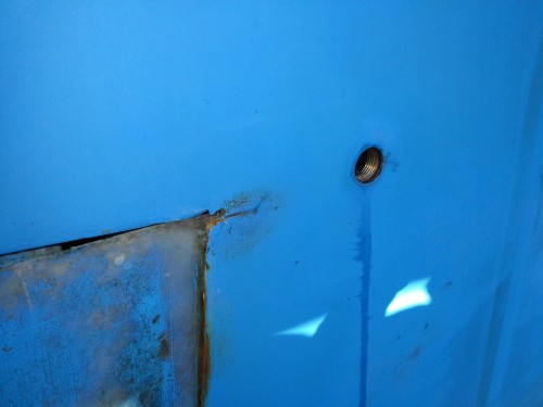

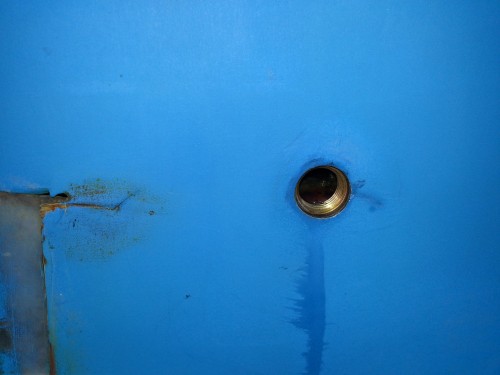

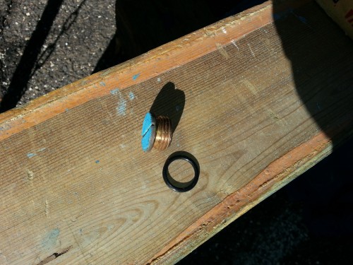

On the 43s the bilge drain plug is located on the starboard side just forward of the trim tab (if your boat still has an operable one at the base of the aft keel stub.
Chris Colton's photo and text shows this very well. I have attached some photos of mine for comparison. It was replaced with a new unit during the winter of 2003-2004. The old unit was in good condition but the slot on the plug had been chewed up by previous gorillas using too small a screw driver so I had it replaced when I was having some work done on the bottom back in 2003.
I have found the secret to keeping the plug from getting chewed up is to use a "Paul Bunion" size screw driver with a tip of at least 5/8". Also I remove the plug at the end of the season and carefully remove the "O" ring and clean the plug and receptor. I always apply a fresh coating of vaseline on the "O" ring and also copper "anti-sieze" paste on the plug threads. This guarantees easy removal the next year.
