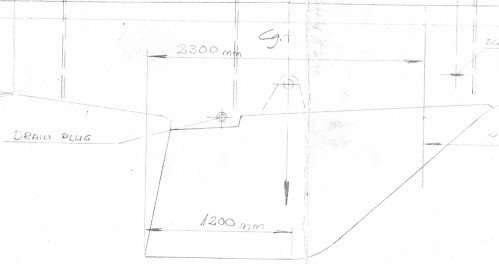

Can a 411 owner tell me exactly where the drain plug is on our boats? I am far away from the boat today, but would like to be able to tell the yard where the plug is, and have never looked for it myself yet. Any help would be appreciated.

An original drawing showing the position of the drain plug.
Notice that it is on the starboard (right) side.
Particular from the original docking plan, 411

I agree with Daniel. The location he shows is the same on hull #11
