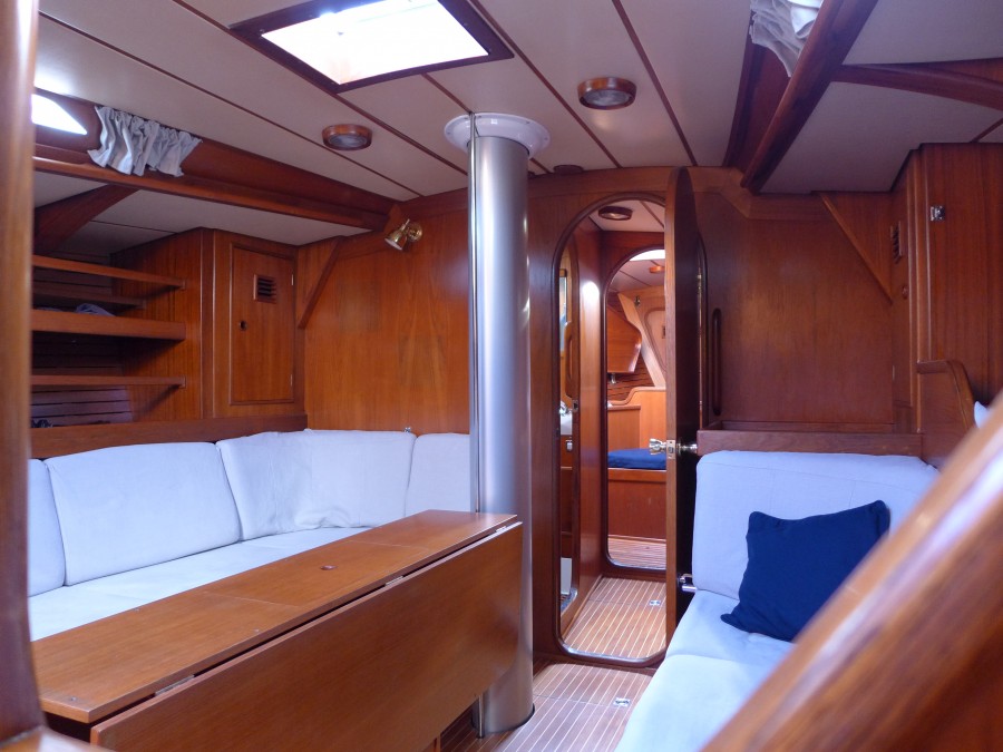

Look forward to see the light and dark contrast of floorboard plywood surfaces in the shape pictured here.

I used a heat gun with scraper to remove 2-part varnish.  I did burn the veneer a few times but after 2-part bleach and very light sanding, all good.
Chris  Mabel's Casse Tete  43/003
