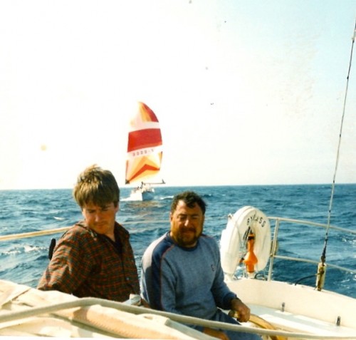

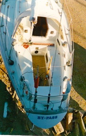

We owned a tiller steered, short rig Swan 37 number 12. We cruised and raced including some long distance two-handed races. Its a truly great boat, but it does have some interesting characteristics. I think Olin was quoted as saying that the boat was designed to get to the windward mark first and that's why is has a relatively small metre boat type rudder blade. Some owners have made this larger. On ours it was the only boat that I've had that would go faster with quite a lot of weather helm - particularly when reaching in strong wind. On the rig, both are fine, but the short rig one was a bit underpowered in light airs and was very stiff.
This shows the tiller length and the rudder
RORC St Malo race in 1987. If you look closely you can see the tiller angle from the centreline as we reach with the spinnaker

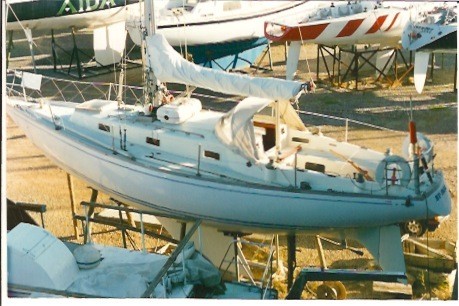

Another view of the cockpit ashore in Berthon's

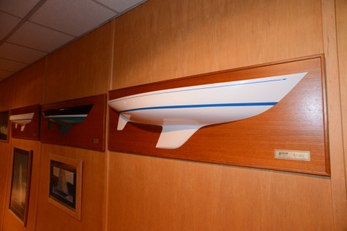

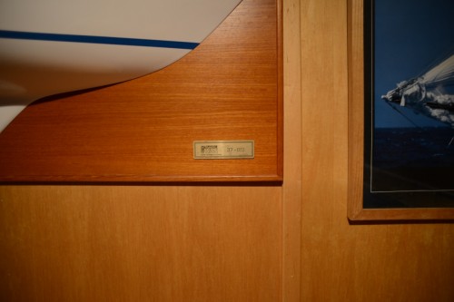

Lars, thanks for the question. I don't still have the original papers but the sail number was K2881. I have attached a couple of pictures of her half model which came from Nautor - which I know doesn't prove anything. I think that she was called By-Pass from new. Regards, Gavin

In the records K 2881 is associated with hull no 013, and if the half model shows 012 there is some unfortunate confusion. Did she have a Builder's Plaque on board?
