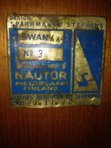

Does anyone know where the Manufacturer ID number (or some call it the VIN number) is located on a 1973 Swan 44? We know where the hull number is (we have hull #3), but cannot find an identification number.

Do you mean this? Indentificatieplaatje Swan 44 That's the only identification we could find.

Thank you, but unfortunately that is not what we are after and it could be quite possible what we are after does not exist on a Swan 44. Other "production boats" have identification numbers stamped, usually on the port or starboard quarter, or on a similar plaque inside the boat, but we can't find any numbers on our boat.

13 December 2013 - 14:28
Norman,
your Plaque is the first introduced by Nautor, while Ice's is the latest (by the way, it has been moved, because it's usually screwed by behind and you don't see any screws in the recto side)
As far as I know there is no other ID number speaking of S&S Swans. I think in those days they did not use to identify boats if not by model and hull #

Builder's Plaques are used by many yards to mark their product. A young yard may not realize that this could be very important later on, and the earliest Swans do not have them. It is known that the second model, Swan 43, at some stage got the aluminium plaque that your attachment shows. Which Swan 43's and possibly Swan 36 member yachts have these plaques? They were prone to corrosion, and may with the time have suffered badly .
For the Swan 44 series early hulls like 002 have the aluminium plaques, but later during the series (hull number unknown) the plaque was changed to the bronze type that Ice displays. The two visible screw heads on this plaque do not represent the original hidden attachment.
