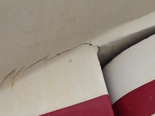

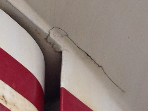

Hey folks,
I need to fix these cracks, which looks easy enough. My questions is, "Are these normal?" Should I be checking the rudder post for problems?

S&S Swans have skeg rudders, and the skeg is the structural component taking the bending loads. The rudder post takes the torque loads.
Cracks in the fairing pieces are cosmetic and probably related to the materials/methods used, but if the cracks extend onto the skeg/hull transition thorough inspection and repair is recommended.
The slots between the fairing and rudder blade appear to be fairly big in the photos, for good rudder performance they should be smaller. Turn the rudder hard over, and check if the fairings can be extended without touching the blade.

This is exactly what I needed. It doesn't look like the cracks are anything more than cosmetic. This is an early 411 hull with the extended skeg. I'll check to see if I can extend the fairing to close the gap. Is there a good method to do that like a foam filler and wrapped fibre?

Actually the skeg may be the same length as the original, but the rudder has been extended.

Suggest you check whether the extensions can be glued/screwed to the inside of the present fairings. FRP or other sheet material which can be glued and painted would be fine.
