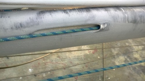

Our SAFA S&S 44 has her original rig (1973) and we took it to lay down to check details. All seems to be OK. (shrouds etc.) except the outlook - this mast profile has not been handled electrically and the color has turned to 'dark aluminium'. We are going to grind the mast slightly, then clean and use some wax to make it shine. Has somebody done operation like this?
What cleaning method, which kind of wax to use?
Rgds, SAFA-team/FINLAND.
Profile near sp. halyard

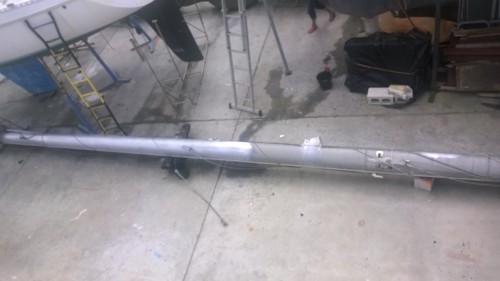

Now is SAFA's original mast renoved with minimum costs. The oxidised aluminium is removed by grinding. I used steelwool with sweet water, grinding with 2 hands! After that, simple washing and waxing two times with car wax for aluminium wheels. Total costs were about 20 euros plus 4 days work (with a little beer and simple food ....). See the photo of ongoing grinding.
