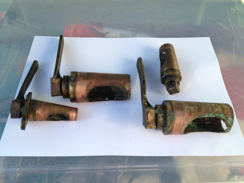

Hello all,
Does anyone know if the Blakes seacocks parts listed in the pictured below are still available? If yes, where?
Sportif greetings,
Ice / Swan 44 "RepoMan"
10 January 2014 - 11:46
Dear Ice,
it is strongly recommended you not to mix parts from different seacocks, but of course you can buy brand new ones from http://www.blakes-lavac-taylors.co.uk/blakes_seacocks.htm. They now have only two available size (3/4 and 1 1/2)
11 January 2014 - 20:12
Dear Ice
If you need to add material to the center plugs one possibility is to use Belzona epoxy based composite repair material.
12 January 2014 - 15:40
your post is like a light in the dark! I always thought that bronze was an alloy to what nothing (but barnacles!) adheres; not long ago I myself tried to fill the pits of my battened MaxProp with an epoxy compound made for fiberglass - a total failure even if I prepared the substrate with a lot of care.
Now Belzona comes out with something that might work: it appears almost like a miracle!
I looked at their site and apparently the proper product is 1151 although they do not explicitly mention bronze. Do you confirm and have actual reports on applications over bronze?
I would be very interested in testing it on my Blakes cones and on my propeller, all badly pitted.
12 January 2014 - 20:12
Dear Daniel
I have the recommendation from a reliable source, but have no personal hands-on experience. Suggest you seek the manufacturer's advice for your application.
