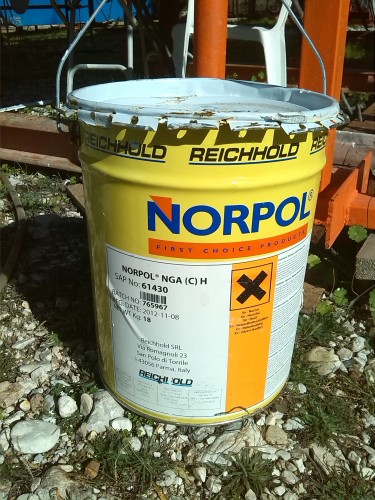

Hi Wolfgang
We are at this time buying direct from a manufacturer in Italy
you can see the address on the can, maybe they will ask you to contact a retail supplier if you only require a small quantity.
I have also used this product on our 41 (Callisto 1) you can see more on our website if you send a personal message as this forum is not for advertising.
With regards
Ron

Hi Wolfang,
The yard give me the same address Written in the can.
