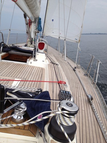

Hello,
Perhaps you might like to consider this layout on Farouche as an example? I am not quite sure if it will fit with the configuration of the 411 considering the spot of the dorades. In my case, the halyard and so on could be run on the side. One thing though, the winches on the coaming on have been moved aft to the cockpi.
Cheers//Philippe
(Farouche 47/050)
Farouche 47/050

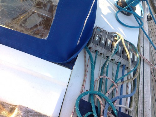

When I bought Wotan Swan 411-40 the previous owner had removed the dorade boxes at the main hatch. He was a keen racer and had a row of clutches and two winches placed beside the main hatch. I am away from home so I only have my existing photo library to show you what it looks like.
I have found the arrangement very effective, though not classic Swan. You can work the running rigging from the security of the companionway at a convenient height to winch. The disadvantage is of course that you loose the benefit of the ventilation from the two dorade vents. If you are thinking of sailing in the Med or the Caribbean I would probably advise against this arrangement.
Anthony
Rearranged clutches
General view, mid-Atlantic
